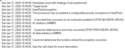

Hi, I'm unable to debug the template project, once debug session is launched the core just stucks in the bootrom:
Also there are some error in the log:

The RAM content is correct:
The board is brand new, I've also attached OPT config is hasn't been modified.
Seem like the macro didn't set PC & SP correctly ? If I set SP & PC manually then the code can be run.

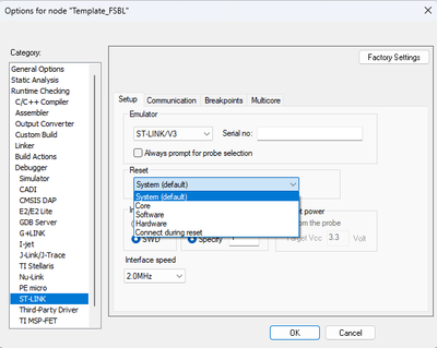

Hello @MasterPhi
Sorry for this issue. Could you try to change RESET mode in Debugger STLink Options of IAR-EWARM ?
Refer to the screenshot below:
Change Reset  to System (default), it will normally fix your issue and halt the cpu in the Reset Handler as defined
in setup.mac (PC at 0x34180404)
For a full debug capabilities, change also the C/C++ optimization from "High Size" to "None" and set a soft break point at the beginning of main.
Let me know if it fix the issue.

Hi @RomainR. , thank you, setting Reset  to System (default) indeed solved the issue.
Also I suggest change execUserSetup into execUserReset in setup.mac, as execUserSetup is only executed once debug session is launched, while execUserReset is also executed when Reset button is pressed. 
Since AXIRAM2 is erased on reset code need to be redownloaded.
