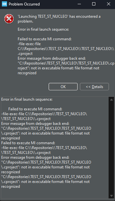

I have created a project with STM32CubeMx based on this evaluation board:
I generate the source code, and I  can compile it correctly from STM32CubeIDE.
The problem is when I try to Run or Debug it, I get this message:
If anyone can help me I would appreciate it.

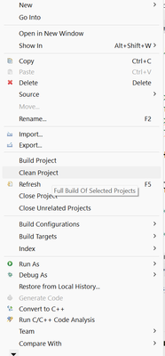

Hello @Refused_HC
Let's try to clean and rebuild your project by following those steps:
In STM32CubeIDE : right click on your project and then clean project as shown below
Then rebuild your project , confirm that the build generates an .elf file
Finally launch your debug session.
THX
Ghofrane
Thanks Ghofrane, but cleaning the project I still get the same error.
