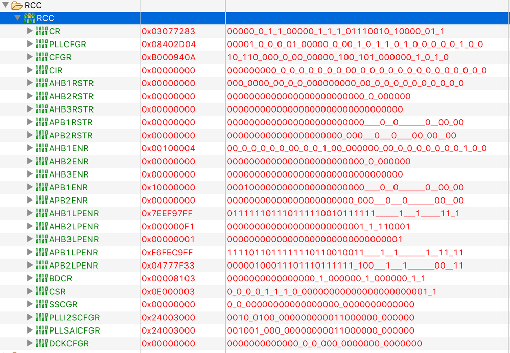

Posted on February 07, 2018 at 12:42
I have configured the MCO with prescaler to output 2 MHz clocked from the system clock, also measured with a scope and found it to be precisely at the 2 MHz.
Also captured RCC register contents (see screenshot).
An additional finding: when the board starts up it measures time correctly up until about 1-2 hours. Then something goes wrong and the timing gets speedy. I have not yet been able to measrure MCO when the problem occurs, once I've done that I will publish my findings. Also I will start logging out the contents of registers to identify if something is changing after this 1-2 hours period.
Also one more info - the core clock is set to 180 MHz (power scale 1, overdrive enabled). Not sure if this is important or not.
