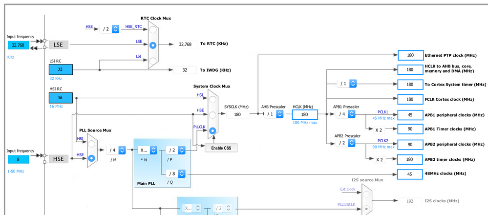

I'm using an STM32F429ZI Nucleo-144 board with CubeMX, enabled FreeRTOS, LWIP, USARTs, IWDG, RTC. The HSE clock source is the on-panel ST-Link 8MHz, the LSE clock source is the on-board 32.768 kHz crystal oscillator.
Since I have recently upgraded to latest cube package version (upgraded FreeRTOS, HAL, CMSIS, Cube libs) I realized that the time base of the panel just got speedy. If I use it to calculate time (and not the RTC), I experience about a 20% overspeed.
I tried using bothe the Systick and Timer1 to provide the timebase source, with the same outcome.
Additional information is that I power the board from external 12V.
Any ideas why this symptoms may come up?
Here are the clock configs from Cube:

and here lies the problem: you keep saying that systick is advancing too fast but vs. what? and how do you know it is advancing too fast?
if you don't help other people help you by laying down some facts, keeping saying it is too fast doesn't really help pin-point your problem(s) here.

Recommend outputting LSE via MCO (PA8) and then scoping it.
Internally you can use TIM5 to benchmark the clock against HSE or PLL, etc

As Clive said, use MCO to push the clock out for monitoring (with prescale if too high), if MCO is used, then
toggle an LED on and off every second and measure 10 blinks to check out the 20% clock mismatch.

Also, read out and post the content of relevant RCC and SYSTICK (STK) registers.

I have configured the MCO with prescaler to output 2 MHz clocked from the system clock, also measured with a scope and found it to be precisely at the 2 MHz.
Also captured RCC register contents (see screenshot).
An additional finding: when the board starts up it measures time correctly up until about 1-2 hours. Then something goes wrong and the timing gets speedy. I have not yet been able to measrure MCO when the problem occurs, once I've done that I will publish my findings. Also I will start logging out the contents of registers to identify if something is changing after this 1-2 hours period.
Also one more info - the core clock is set to 180 MHz (power scale 1, overdrive enabled). Not sure if this is important or not.

And the Systick registers content?
Of course, both are interesting only when the problem occurs.
