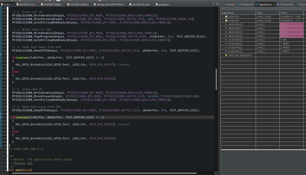

STM32H747I + MT25QL512ABB BlockErase function erases previous block
eziya76
I am reposting this issue because, while debugging, I've determined that the root cause is related to the Erase operation, not the reboot, as I had initially thought in my previous post.
Previous post: https://community.st.com/t5/stm32-mcus-products/stm32h7-qspi-flash-incorrect-data-after-reboot-initial-write/m-p/830635#M284116
Board: STM32H747I-DISCO
Development Environment: STM32CubeIDE 1.19.0
Library: https://github.com/STMicroelectronics/stm32-mt25ql512abb
My code executes in the following sequence:
1. Initialize QSPI and the MT25QL512ABB flash memory.
2. Erase a 4K block starting from address 0x0.
3. Write 256 bytes (aTxBuffer) to address 0x0.
4. Read back the 256 bytes from address 0x0 into aRxBuffer.
5. Compare aTxBuffer and aRxBuffer.
6. Erase a next 4K block starting from address 0x1000 (4096).
7. Read the 256 bytes from address 0x0 again into aRxBuffer.
8. Compare aTxBuffer and aRxBuffer.
My expectation is that the erase operation in step 6, which targets the 4K block at address 0x1000, should not affect the data previously written at address 0x00.
However, as you can see in the debug screenshot below, the data in aRxBuffer appears to have been erased.
The following links seem to describe cases similar to mine:
https://github.com/leekheee77/kwanhee/issues/1
https://github.com/STMicroelectronics/stm32-external-loader/issues/11

void MT25QL512ABB_Test(void)
  // 1. Prepare data with a pattern unique to the address
  for(uint16_t j = 0;j < TEST_BUFFER_SIZE;j++)
    aTxBuffer[j] = j;
  // 2. Erase 1st 4K
  MT25QL512ABB_WriteEnable(&hqspi, MT25QL512ABB_QPI_MODE, MT25QL512ABB_DUALFLASH_ENABLE);
  MT25QL512ABB_BlockErase(&hqspi, MT25QL512ABB_QPI_MODE, MT25QL512ABB_4BYTES_SIZE, 0x0, MT25QL512ABB_ERASE_4K);
  MT25QL512ABB_AutoPollingMemReady(&hqspi, MT25QL512ABB_QPI_MODE, MT25QL512ABB_DUALFLASH_ENABLE);
  // 3. Write data to 0x0
  MT25QL512ABB_PageProgram(&hqspi, MT25QL512ABB_QPI_MODE, MT25QL512ABB_4BYTES_SIZE, aTxBuffer, 0x0, TEST_BUFFER_SIZE);
  // 4. Read data back from 0x0
  MT25QL512ABB_ReadSTR(&hqspi, MT25QL512ABB_QPI_MODE, MT25QL512ABB_4BYTES_SIZE, aRxBuffer, 0x0, TEST_BUFFER_SIZE);
  if(memcmp(aTxBuffer, aRxBuffer, TEST_BUFFER_SIZE) != 0)
    HAL_GPIO_WritePin(LED3_GPIO_Port, LED3_Pin, GPIO_PIN_RESET); //error
  else
    HAL_GPIO_WritePin(LED1_GPIO_Port, LED1_Pin, GPIO_PIN_RESET);
  // 5. Erase 2nd 4K
  MT25QL512ABB_BlockErase(&hqspi, MT25QL512ABB_QPI_MODE, MT25QL512ABB_4BYTES_SIZE, 0x1000, MT25QL512ABB_ERASE_4K);
  // 6. Read data back from 0x0
  else

  hqspi.Instance = QUADSPI;
  hqspi.Init.ClockPrescaler = 1;
  hqspi.Init.FifoThreshold = 1;
  hqspi.Init.SampleShifting = QSPI_SAMPLE_SHIFTING_HALFCYCLE;
  hqspi.Init.FlashSize = 26;
  hqspi.Init.ChipSelectHighTime = QSPI_CS_HIGH_TIME_3_CYCLE;
  hqspi.Init.ClockMode = QSPI_CLOCK_MODE_0;
  hqspi.Init.DualFlash = QSPI_DUALFLASH_ENABLE;
  if (HAL_QSPI_Init(&hqspi) != HAL_OK)
    Error_Handler();

In DUAL FLASH mode you are talking to TWO MT25QL512 in an interleave mode, one operates on ODD addresses and the other on EVEN, both see the same command/address portion.
Your ERASE 4K BLOCK now operates on them as a PAIR, so an 8KB ERASE BLOCK, you must also read a PAIR (TWO) STATUS BYTES, and BOTH must indicate the operation has completed.
Similarly a WRITE PAGE has 512 bytes and must not span a 512-byte aligned address, instead of 256-byte
2 REPLIES 2
@Tesla DeLorean
Thank you so much for your detailed answer. I wasn't aware that Dual Mode operates on even and odd addresses.
I changed the second erase start address to 0x2000 in the example, and I can confirm that the data at address 0x0 was not erased, just as you explained.
I really appreciate you taking the time to help me with this.
