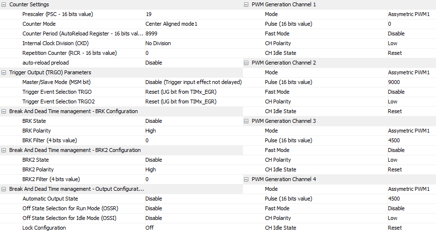

TIM1 (Simulated encoder output): 200Hz
TIM1 (CH1, CH3) output looks like this (verified with oscilloscope):

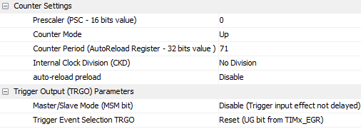

TIM2 (Timer update interrupt with 1us interval): 1MHz

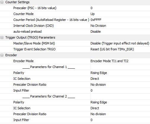

TIM3 (Encoder interface):

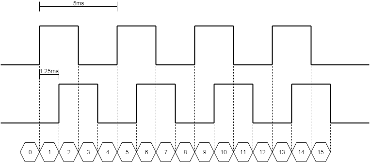

Using X4 encoding I expect that the TIM3 counter will be incremented once every 1250us (see picture above). However the times I get using this approach is 61-62us less. This is the ten sampled values I get (there is something in my implementation that gives a value twice as big the first time):

I noticed if I change the speed of TIM2 to half, (Prescaler above is set to 1 instead of 0) and get interrupts every 2us instead then it looks much better:
2500, 1250, 1250, 1250, 1250, 1250, 1250, 1250, 1248, 1250
Any ideas why it looks better when I slow down TIM2 to 500KHz? How does one determine the correct prescaler/counter period for the different timers? I am confused, I can see that the results change when i change prescaler etc. but I don't understand how it is all related, now I've just used trial and error. If you need more information let me know.

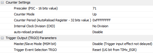

I changed TIM2 to this:
This way it will increment the counter once every 1us and then I use the Capture/Compare interrupt of the encoder interface (TIM3) to handle each change of the counter. Here I can check how much time has elapsed using the TIM2 counter and I now get better results:
2500, 1250, 1250, 1250, 1249, 1250, 1250, 1250, 1250, 1250
Given the max speed of the motor I will now get interrupts at most every ~40us instead of every 1us like in my first attempted solution.
Still I will try to figure out a solution using DMA.
