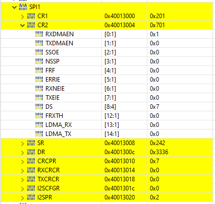

Hi, I am trying to synchronize a SPI Block data transfer between two MCU's (Ti MSP430 Master, STM32G0 Slave). The idea is to use the DMA to transfer the data to memory and use the DMAMUX to Sync with a timer.
For demonstration, the data is transmitted to USART.
Here is my result:
The red cycle mark the sync point generated by the timer interrupt of LPTIM1.
For testing, a defined pattern with 6Byte is transmitted via the SPI. And you can see that the data is not in sync with the block transmission.
Has anyone an idea how to solve this?

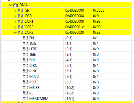

SPI1 is configured to receive the data in Slave mode and use DMA.
DMA Channel 3 is configured to transmit data from SPI1Rx to memory
DMAMUX Channel 2 is configured to SPI1Rx synced by LPTIM1
MGons.1
Today I was able to solve the problem by myself.
The solution was to set the FRXTH bit from the SPI configuration.
Now all data is transmitted via the DMA.

Sorry I do not understand you. Currently, the Master (MSP430) is driving the communication.
The goal is that the bytes that are send by the MSP will be received in sync by the STM32G0.
Like shown in the picture above the received bytes are shifted by 2 bytes. And that is what I have to avoid.
MSP is sending 0x31;0x32;0x33;0x34;0x34;0x35;0x36
STMG0 has received (DMA TC ISR) 0x25;0x26;0x31;0x32;0x33;0x34
The first 2 bytes are from the last data block.
I want to use the synchronization signal of the DMAMUX raised by the LPTIM1 to solve this problem.
