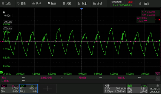

Previously, I used the HAL_DFSDM_FilterRegularStart_DMA method to enable each of the eight filters one by one. The result was a 2.4Mhz clock output, exactly as configured in CubeMX.

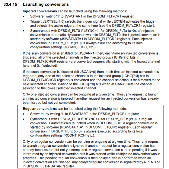

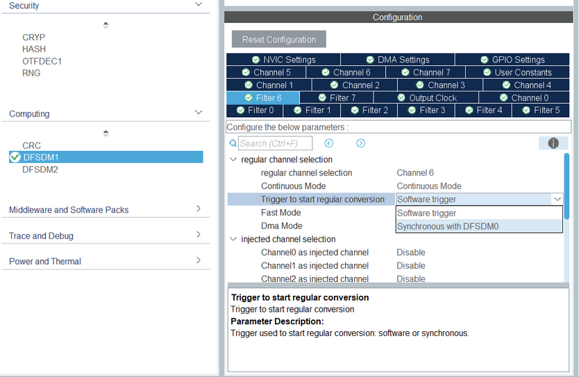

Now, to achieve high sync between 8 filters, i referred to the synchronization content in the reference manual(RM0455):
i followed the instruction and programmed as below:

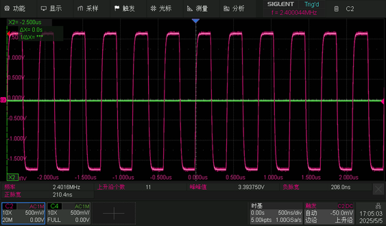

hdfsdm1_filter0.Instance->FLTCR1 |= DFSDM_FLTCR1_RSWSTART;However, when I checked the CLK output, I found that the clock frequency changed to about 3Mhz, varying from 2.6Mhz to 3.0Mhz. See below:

In addition, I suggest to avoid the direct update of registers values.
(for instance "hdfsdm1_filter0.Instance->FLTCR1 |= DFSDM_FLTCR1_DFEN").
You can perform the synchronization of the 8 filters with only some little updates on configuration parameters.
I suggest to perform the following updates :
1) Remove the call of function WJ_DFSDM_FilterSyncConfig.
2) Remove the updates of FLTCR1 registers at the beginning of WJ_DFSDM_FilterSyncStart function.
3) Remove the start of conversion by update of FLTCR1 register.
4) On MX_DFSDM1_Init function, keep DFSDM_FILTER_SW_TRIGGER for DFSDM1_Filter0 instance
but use DFSDM_FILTER_SYNC_TRIGGER for all other filter instances
(hdfsdm1_filter1.Init.RegularParam.Trigger = DFSDM_FILTER_SYNC_TRIGGER).
This will set RSYNC bit on FLTCR1 register of corresponding filter.
5) On WJ_DFSDM_FilterSyncStart function, start acquisitions on all filters as already done by calling
HAL_DFSDM_FilterRegularStart_DMA but start first filters from 1 to 8 and finally, start filter 0.
This will first enable all filters except filter 0 and guaranty a correct synchronization when finally, you start filter 0.
This will launch synchronous acquisitions on all filters.

2025-05-16 1:15 AM
I have implemented the synchronous configuration as your suggested, and it now works properly. However, I discovered an issue with CubeMX during this process:
I used CubeMX to change DFSDM_FILTER_SYNC_TRIGGER to DFSDM_FILTER_SW_TRIGGER , but it seems that CubeMX UI mistaken Filter0 to DFSDM0, it should be " Synchronous with Filter0 ", instead of " Synchronous with DFSDM0 ", as STM32H7B0 doesn't embed a DFSDM0, and " DFSDM0 " was not mentioned in reference manual (RM0455) as well.
Have you encountered similar discrepancies in CubeMX's DFSDM configuration for H7 series devices? It would be helpful to confirm whether this is a known issue or requires a firmware update.
