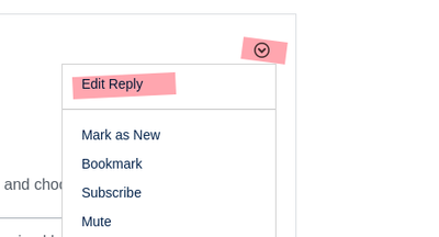

‎2024-06-26 1:03 PM - edited ‎2024-08-15 2:28 PM
> (how to edit old posts?)
@tjaekel, click the little drop-down arrow located above the post's date/time and choose "edit reply".
- Please post an update with details once you've solved your issue. Your experience may help others.
