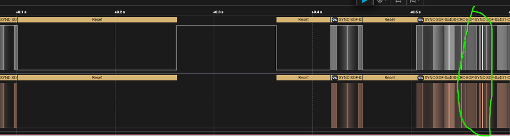

Hello everyone, I have been researching and developing the stm32f072c8t6-based development board for about a few months without any converter or St-link programmer products, so I am choosing USB line products specifically.
But there is a problem that this MCU cannot connect directly to the computer, the MCU needs a USB Hub (Forum link at the bottom of this post.)

By the way, when I watch the MCU's communication with the Computer with the Logic analyzer, I see that it constantly gives this table Dec:
name type start_time duration value   (Numbers are seconds)
USB LS and FS v1frame -0.000000083 0.000000667 SYNC
USB LS and FS v1frame 0.000000583 0.000000667 PID SOF
USB LS and FS v1frame 0.00000125 0.000000917 Frame # 0x166
USB LS and FS v1frame 0.000002167 0.000000417 CRC OK 0x0D
USB LS and FS v1frame 0.000002583 0.00000025 EOP
USB LS and FS v1frame 0.000999917 0.000000667 SYNC
USB LS and FS v1frame 0.001000583 0.000000667 PID SOF
USB LS and FS v1frame 0.00100125 0.000000917 Frame # 0x167
USB LS and FS v1frame 0.001002167 0.000000417 CRC OK 0x12
USB LS and FS v1frame 0.001002583 0.00000025 EOP
But if I press the reset button, a different result comes out:
After NRSTAfter NRST
I think the MCU is trying a connection in the marked field;
The First PID SETUP area:

Like that, I didn't quite understand the situation I was in, but these are the findings I was able to get, I want to overcome this situation because there aren't too many different options for changing the design of the MCU.
By the way the system gets its power from Vbus line and there is nothing on D+, D- lines, traces are short and of equal length. I also tried many different combinations but the result is always the same.
Thank you.

So your device works with a hub but not directly with a computer. Try a different computer from a reputable brand (but not a mac book). If still does not work, the device likely has electrical USB compatibility problems, and USB SIG tests are recommended.  If the device works with more than one "good" computers, blame the other computers )) and use hubs as you already do. Good hubs can straighten some electrical issues.
