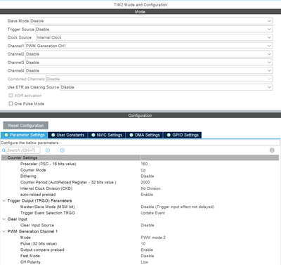

Hi folks,

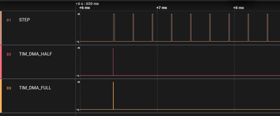

I'm trying to use a timer to generate a PWM output on a single output channel, but vary the frequency each cycle by updating the ARR register with DMA updates.  I think I set everything up correctly, but when I call HAL_TIM_Base_Start_DMA(), I don't see any ARR updates [it remains at the value configured in CubeMX].  I also registered interrupts to trigger when the DMA is half-complete and fully-complete, and have them toggle GPIO pins.  I see no triggering of the interrupts either.  No errors reported when calling any of the HAL functions, so it looks like the updates are not being triggered for some reason.  The U5 GPDMA has a lot more to configure than the DMA on the L5 I used previously, so quite possible I've misunderstood or misconfigured something.
Timer configuration:
The counter period of 2000 is just a placeholder I expected to get overwritten by the DMA update.

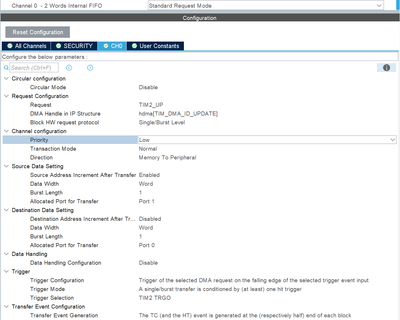

The GPDMA1 CH0 configuration:
I'm not sure if the trigger configuration is correct or even necessary.  I've tried with it disabled, and with rising and falling edge trigger, with none of them having any obversable difference.  Does TRGO set up UPDATE in the TIM2 configuration trigger this here?  If so, does TIM2 trigger an update on start, or only after the first cycle?

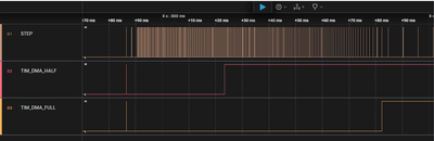

With a logic analyser, I see a steady frequency matching the 2ms period from the CubeMX configuration, not the varying frequency I expected:

You already have TIM2_UP set up as the request source for the DMA channel. I think defining a trigger for the DMA channel acts here as additional "gating" of the request, which is not what you want. The docs are very undisciplined about mixing these two terms ("request" and "trigger").

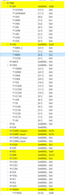

I'll look at using live expressions or data watchpoints.  I was pausing the debugger and looking at the live expression after a certain time.  But the values are all the initial values, I see no evidence of them changing if I start and stop again.  Looking at the GPDMA registers, it looks like it has all of the initial start addresses for source and destination and the number of values to transfer is the initial value--it seems it's all set up to go but hasn't actually been triggered to do anything!
"samples" is filled with usable values, checked in the debugger.
I'll disable the "trigger" in the GPDMA channel configuration, and see if I can find better documentation of what it's intended for; the GPDMA docs I've seen so far don't really go into any detail about this.
TIM2_DIER.UDE is definitely enabled.

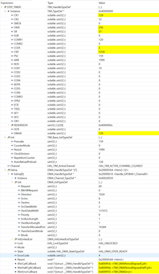

Thanks for the reply.  You're certainly right about the cache; I switched it to using HAL_DCACHE_CleanByAddr() instead.
The timer is definitely started; I can see CNT incrementing, and I can also see the PWM output from the channel.  By the way I only used TIM_CCxChannelCmd here to enable the channel output before starting the base timer with DMA updates.  If there's a better way of achieving this with the HAL API, I would be interested to know what is the recommended way to do this.

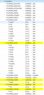

I couldn't see "NDTR" in the registers or the HAL structures.  Is this the hdma ready state?

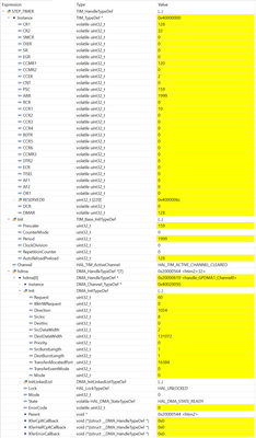

After HAL initialisation, I see this:
rleighelectradx_0-1725563212295.pngrleighelectradx_1-1725563294294.pngrleighelectradx_2-1725563394468.png

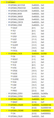

And then after starting the timer with DMA:
rleighelectradx_3-1725563476344.pngrleighelectradx_4-1725563521745.pngrleighelectradx_5-1725563553095.png
All of the DMA source and destination addresses and sample count are correct as the initial values, but it looks clear that no transfers took place.
I see that there is an error code of 4 in the hdma structure, so that's likely an indicator of the fault.

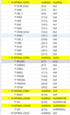

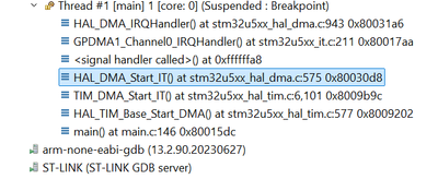

Indicates a user setting error:
#define HAL_DMA_ERROR_USE (0x0004U) /*!< User setting error */
In that case, HAL has determined something is amiss. Probably stepping through HAL_TIM_Base_Start_DMA would show where this happens and why. Possibly a CubeMX generation issue.
Thanks, I've pinned down when it happens:
Unfortunately it's in the return statement at the end, so it's triggered immediately after calling __HAL_DMA_ENABLE(hdma) and not in any of the setup code directly.  It at least identifies where to dig next!
I'm assuming that since this validation error arises directly from the GPDMA1 peripheral, the error must be in either the CubeMX configuration (or the code gen if it's a bug).  Looking at the actual registers which are validated:
I can't see anything overtly wrong with regards to the source or destination transfer size, burst size, address increment or anything.  Likewise the BNDT/SA/DA are all exactly as I would expect.  Source and destination ports should be fine. All the pointers are valid.  REQSEL is GPDMA1_REQUEST_TIM2_UP.  I'll go through the "user setting errors" and see if I can spot which one I'm violating.

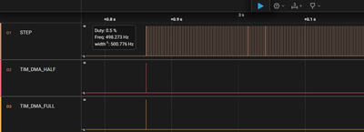

The solution was a very simple one.  The BNDT is in bytes, not bursts, so I was off by a factor of four.  Multiplying by four made it come to life nicely:
The only remaining niggle is that the first two pulses are using the default ARR value before the DMA updates kick in.  If it's possible to eliminate them, maybe by turning on the channel at that point, that would be perfect.
Thanks everyone for your input so far, this is a great step forward after a day of getting quite frustrated with the reference manual!
