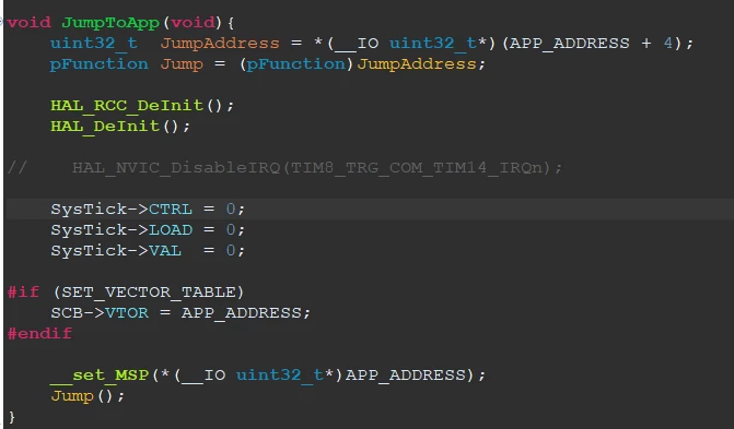

Hi, I have some problem about IAP.
It's not working application after jump from custom boot.
- MCU : Stm32F446RC
- Board : Custom board
- Boot address : 0x08000000 ~ 0x0801FFFF (128k)
- Application address : 0x08020000 (384k)
- Custom Boot Flash.ld
- Application Flash.ld

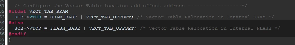

- Application system_stm32f4xx.c
- Jump to App code

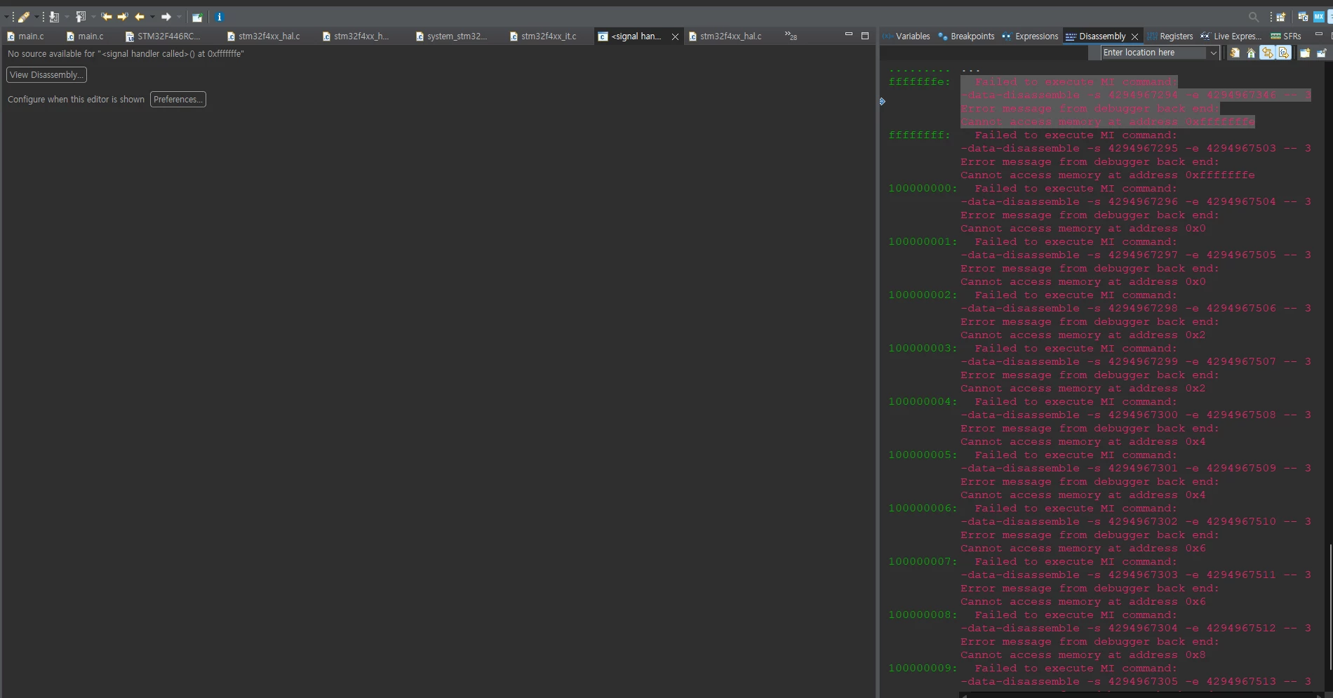

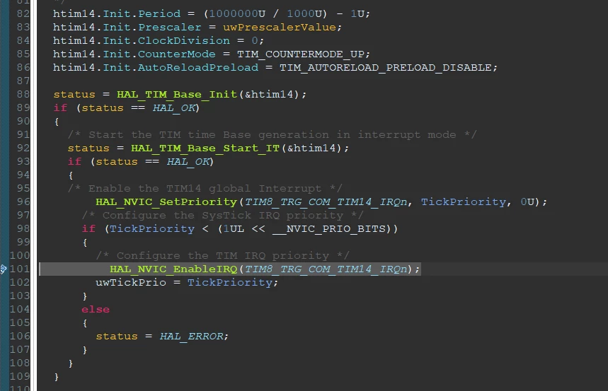

I got the problem here
- HAL_Init() -> HAL_InitTick(TICK_INT_PRIORITY) -> HAL_NVIC_EnableIRQ(TIM8_TRG_COM_TIM14_IRQn) in stm32f4xx_hal_timebase_tim.c

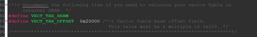

Ahh you dont read i write RAM and this is 128k only. Then vector offset cant be 0x20000.
Comment out this and all works
//#define VECT_TAB_SRAM

>>Anyone have some solution? Please answer me.
Use the Debugger, and step over the code.
Make sure that the vector table has viable content, and not filled with 0xFFFFFFFF
Failure suggests you're jumping anyway, or you reactivate an interrupt and it vectors there. Perhaps validate entire image say with signing or CRC.
Be a bit more circumspect before changing the SCB->VTOR and handing off control. Instrument your code so it's more apparent what's happening and why.

Your config cant work . You set RAM vectors with offset to non existed RAM area...
>>But it's same problem..
Define the "problem" better
Show that SCB->VTOR = 0x08020000
Show what's happening as you step into the application
Show the point of failure, with registers and disassembly
Instrument so you can dump peripheral and cpu registers
If failing interrupts, show NVIC, show Vectors
Omg.. thanks a lot.
it's working now..
