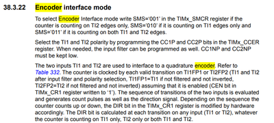

I have read Reference Manual many times and sorry, its not "great depth":
* What is Timer internal input frequency, on clock configuration, there is APB1 / APB2 Timer clocks, what is what
* Trigger controller / Slave controller / Encoder interface is just like black box, no good explanation
* StmCubeMx configuration and Reference Manual don't match, example on manual "External clock mode1: external input pin (TIx)" , but on Reference Manual timer block diagram there is TIMx_ETR and same on StmCubeMx.
* ITR input detailed explanation
... and this is just begginning
Github example also don't help, because uses internal clock and StmCubeMx generates different code.
The clock tree in CubeMX provides a good visualization. Have you looked at it? The RM also goes into great detail about this.
Did you read this section? What is unclear? Only a partial screenshot.
Maybe you're mistaking the datasheet for the reference manual.
