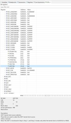

Hi F.Belaid, thank you for your help with this. As you suggested, I tried using PLL1P to clock the ADF1 peripheral and it works properly. I have not tried AUDIOCLK or HCLK yet, but so far PLL1P and MSIK clocks both work as expected. But PLL3Q still does not work. Both PLL1P and PLL3Q are sourced from and external 12.288MHz quartz crystal.
I used an oscilloscope to probe the ADF1_CCK0 pin (PB3) and no clock appears as an output on this pin when using PLL3Q. I can see a clock signal when using PLL1P or MSIK clock sources.
I've attached a screenshot of the RCC_CCIPR3 register when PLL3Q is selected as the clock source

Thank you for the feedback, I reproduced the issue. I suggest this workaround,
__HAL_RCC_PLLCLKOUT_ENABLE(RCC_PLL3CFGR_PLL3QEN);
instead of  //ret = RCCEx_PLL3_Config(&(pPeriphClkInit->PLL3));
Hope this helps!
