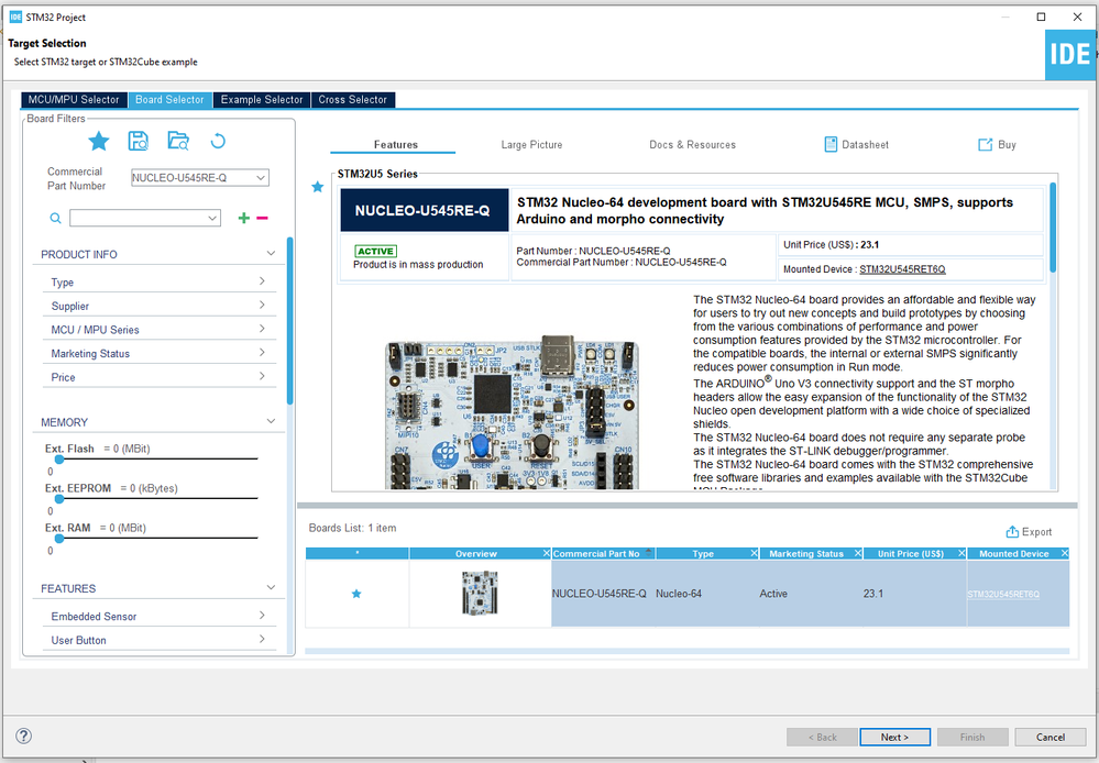

1. Create a project

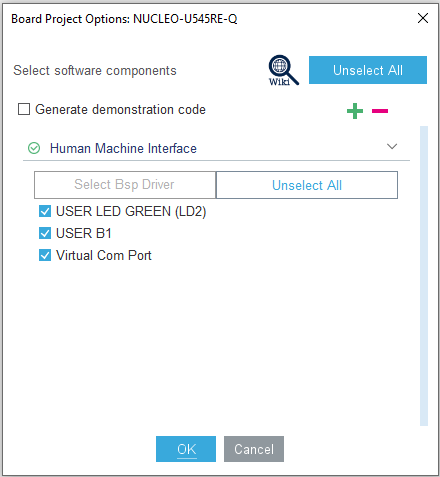

Start a new project in STM32CubeIDE by selecting File → New → STM32 Project. Navigate to the [Board Selector] tab and choose [NUCLEO-U545RE-Q].
2. Keep the default board options

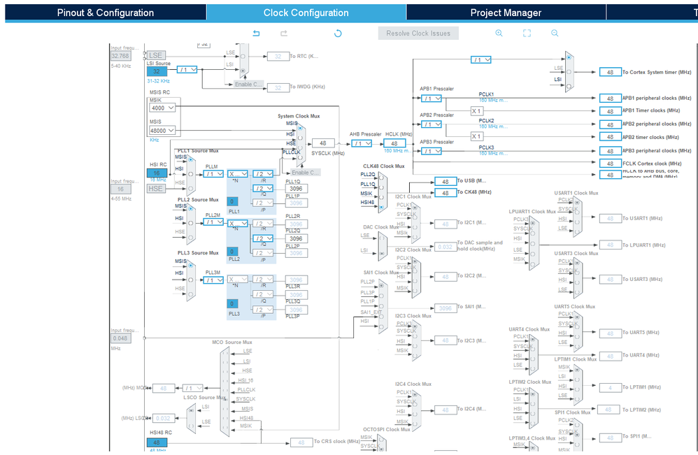

4.  According to the reference manual, the USB peripheral requires a minimum clock frequency of 48 MHz to avoid data overrun and underrun issues.
RM0456 Rev 6 Reference manual STM32U5 series Arm®-based 32-bit MCUs
pg. 3087/3653 The USB peripheral implements an interface between a full-speed USB 2.0 bus and the APB2 bus.
pg. 3094/3653 Note: Due to USB data rate and packet memory interface requirements, the APB2 clock must have a minimum frequency of 12 MHz to avoid data overrun/underrun problems.
pg. 3141/3653 Caution: To guarantee a correct operation for the USB OTG FS peripheral, the AHB frequency must  be higher than 14.2 MHz.
This being a low power device I would have liked to run SYSCLK & APB2 at lower frequency to save power but for good measure, I set SYSCLK, APB2 and USB clocks all to 48MHz.

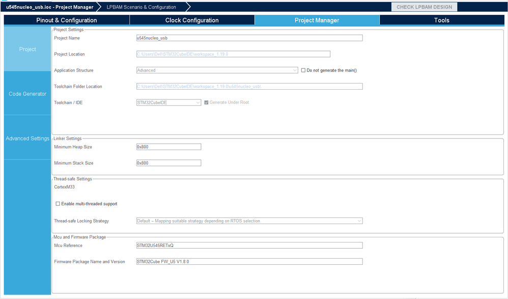

5. For good measure set the Minimum Heap and Stack Sizes as below.

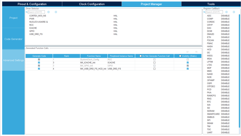

6. No changes should be required in Advanced Settings
7. Save the Mx configuration and Generate Code

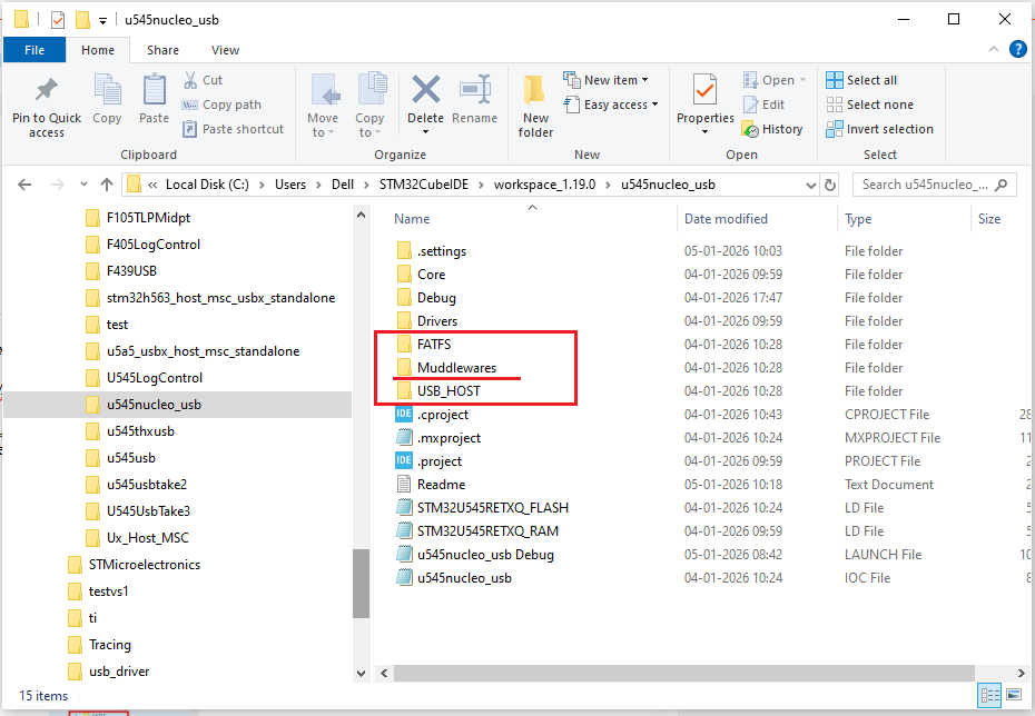

8. In File Explorer, copy FatFs, Muddlewares and USB_Host folders from the sample project on github (refer the link provided at the start of this article).
Note that I have renamed the folder as "Muddlewares" because "Middlewares" could be deleted if CubeMX is used for further round-trip code-modifications.  I am using STM32CUDEIDE v1.19.0 as I like the round-trip feature.
9. Refresh the Project in CubeIDE to view the copied folders

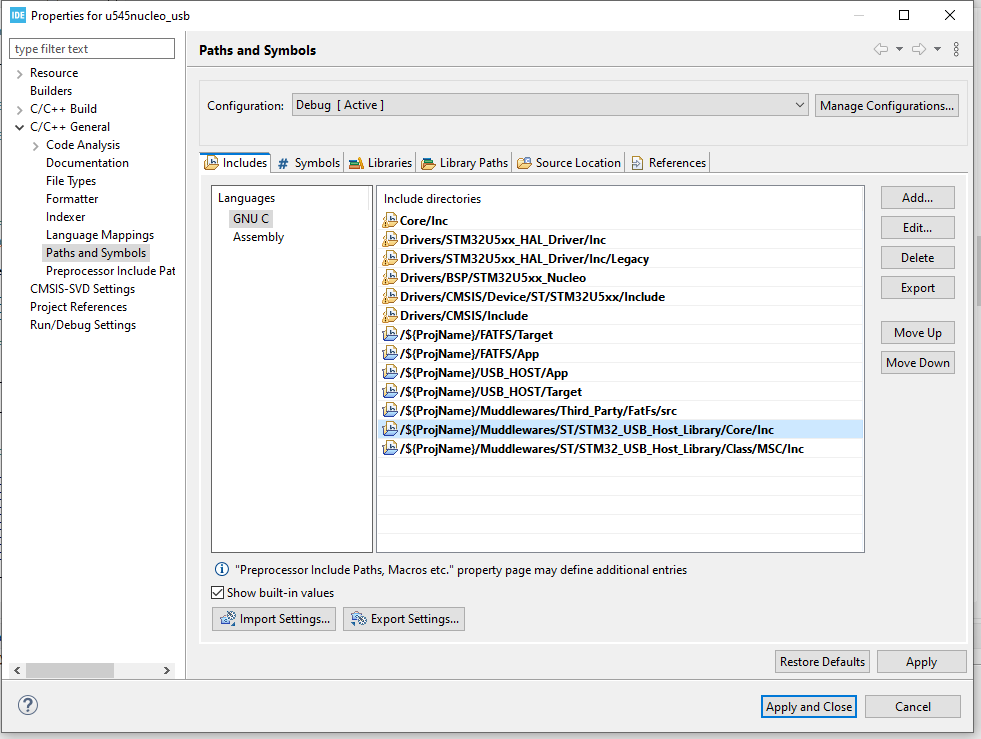

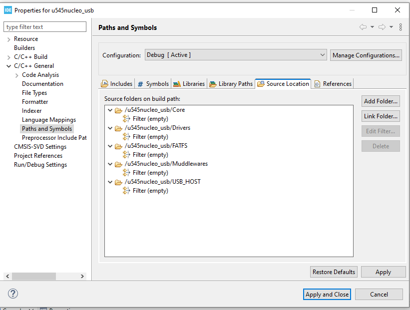

10. Add the Paths related to the source files
11. Add header paths
12. Save the MX configuration and Generate Code

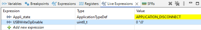

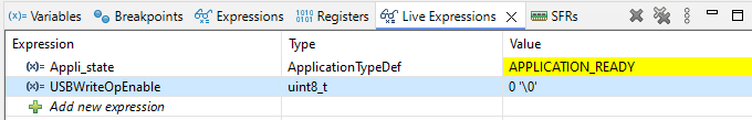

17. Add Appli_state and USBWriteOpEnable to the Live Expressions Watch Window.
Appli_state will be APPLICATION_DISCONNECT initially when the USB Pen Drive is not connected.
18. On Connecting the USB Pen Drive, the Appli_state changes to APPLICATION_READY
From the Watch Window set USBWriteOpEnable to 1. It will be immediately set back to 0 indicating successful operation.
19. Unplug the USB Pen Drive and the Appli_state changes back to APPLICATION_DISCONNECT .

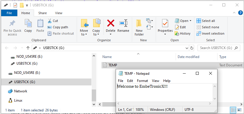

20. Plug-in the USB Pen drive into the PC and check its contents as below
