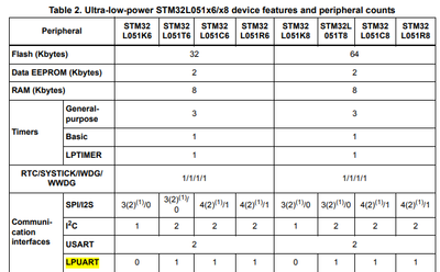

Can STM32L051 set LSE be LPUART clock source to wake up the MCU? If yes, how to configure.

Based on your product Datasheet, yes, a 32.768 kHz clock (LSE) is needed to allow LPUART communication up to 9600baud. Therefore, even in Stop mode, the LPUART can wait for an incoming frame while having an extremely low energy consumption.
except if you have the STM32L051K6, it does not support LPUART

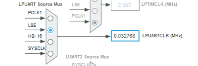

to configure it, just enable your LSE in your RCC configuration
enable your LPUART
and select LSE as input for LPUART in clock configuration
