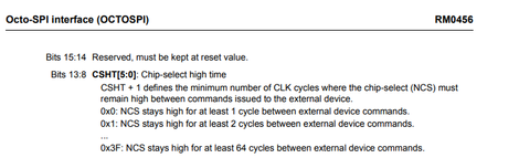

For the OCTOSPI interface, the chip-select high time CSHT[5:0] represents the period between two
successive operations in which the memory is deselected. This time must be configured according to the device datasheet. So, it can be used to specify the minimum number of CLK cycles for which the NCS must remain high. Please see RM0456.
For more information please take a look at AN5050 5.2 OCTOSPI/HSPI/XSPI configuration for Regular-command
protocol section and Overall FAQs for QUADSPI/OCTOSPI/HSPI/XSPI "1.6. How to calculate the chip select high time".

Thank you KDJEM.1 for trying to help. It looks like you may have misunderstood me: I'm interested in inserting clock cycle spacing (i.e. a "zero" at length of 1 clock cycle or more) between consecutive bytes, not between operations.
