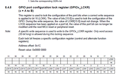

There is no clear information in the reference manual about port pin configuration locking one by one. For example (desired code):
void SomeFunction()
  // locking pin configuration one by one
  LL_GPIO_LockPin(GPIOA, LL_GPIO_PIN_0);
  LL_GPIO_LockPin(GPIOA, LL_GPIO_PIN_1);
  LL_GPIO_LockPin(GPIOA, LL_GPIO_PIN_2);
May I lock pin's configuration one by one, not all at once (see code below)?
void OtherFunction()
  // locking all pins configuration at once
  LL_GPIO_LockPin(GPIOA, LL_GPIO_PIN_2 | LL_GPIO_PIN_1 | LL_GPIO_PIN_0);

Yes, you can lock only 1 pin for each call of the LL_GPIO_LockPin.

You can do it with both ways, by Oring all pins or one by one, but better to lock them at once for performance reasons.
This is the register:
You can write all the bits at once (by oring).
See also this linkLL_GPIO_PIN_ALL value is the oring of all pins.

Thanks a lot, colleagues! In my application it is very convinient one by one way of configuring port pin locking.
