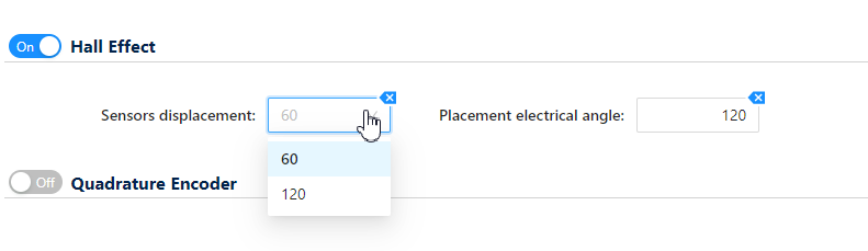

I am trying to use 6-step sensored control. I have a 3-pole pair (6 permanent magnets) motor. The hall sensors are placed 40 degrees apart mechanically so that I get 120-degree electrical spacing. The V5 and V6 MC SDK only support 120 and 60 mechanical degrees for hall sensor placement. I am wondering if this is contributing to my problem below.
The problem is that when I try to spin the motor up, I get speed feedback error in the MC SDK motor pilot tool.

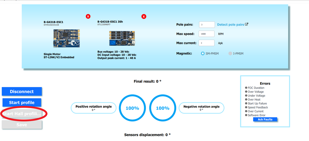

I see V6.1.1 has hall sensor built into profiler. I tried that, but problem is its greyed out.
_legacyfs_online_stmicro_images_0693W00000bj8kUQAQ.pngAlso, motor profiler was hard to get running see below:

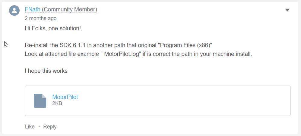

Profiler gets stuck re-programming dev-kit as described here:
https://community.st.com/s/question/0D53W00002EtFP6SAN/how-do-i-operate-motor-profiler-from-motor-pilot-v115
Profiler solution fix:
https://community.st.com/s/question/0D53W00002A1SntSAF/st-motor-pilotprofiler-will-not-connect
