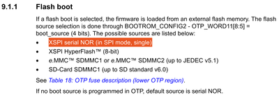

No boot source is programmed in OTP default source is serial NOR

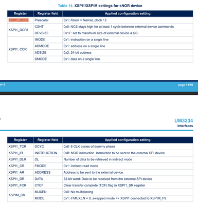

No configuration needed
Default settings for the XSPI from the ROM

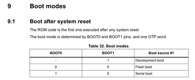

Flash is the boot when Boot1 (low) Fairly curtain thats sNor flash.

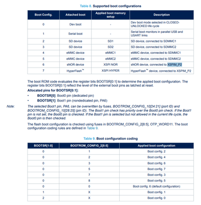

bootrom configuration table
* BOOTSR == boot rom switches

Your understanding is correct.
By default, in Flash_Boot mode (BOOT0 = BOOT1 = 0), the STM32N6 BootROM configures XSPI1 on Port 2 in single‑SPI mode with the parameters defined in Table 14 of UM3234. This allows the system to boot and copy a signed FSBL binary into the internal AXISRAM2.
Afterwards, depending on the external NOR Flash memory you plan to use, the final configuration must be performed in your FSBL using the External Memory Manager middleware.
