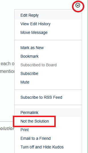

@Nixxen wrote:
I did not intend to accept this as a solution.
How to unmark the solution:

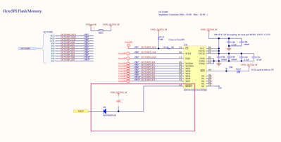

If you have a reset connection issue, external memory supplies (VDD_MEM1 and VDD_MEM2) must be cut for more than 1 ms to allow reboot on reset. For that I advise you to respect the recommendation.
Could you please share your schematic?
Thank you.
Kaouthar
when rebooting we cut the power for 2-3 seconds on the whole board so this shouldnt be an issue. I attached our Flash-Schematics. We later added a connection betweenn the MCU NRST and the Flash-Reset Manualy which is not shown in the schematic.

Hello @Nixxen ;
After checking your schematic, your aren't used a reversed diode to each of all external RESET pins of external memories as recommended in Getting started with hardware development for STM32N6 MCUs - Application note.
I recommend you to correct this issue by adding a reversed diode. Please let me know if the issue is solved or not?
I advise you to refer to Nucleo-N657X0-Q schematic and check your schematic.

after our own Investigations we were able to pin Point and fix the Issue. The connection between PN7 and the reset lead to issues with booting from flash in Flash boot. Removing the connectiong resistor Solved the issue.
The Upload to the flash in dev Boot still doesn't work, but we are not able to do the required Hardware modification to figure out the Issue, but we have a software workaround. For sake of documentation the Workaround consinsts of 2 steps. First using the STMCubeIDE to upload and run a basic firmware image into Ram which initialises the Flash and then the Programmer schould work as expected.
