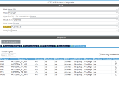

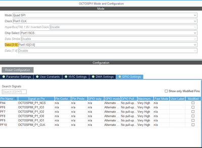

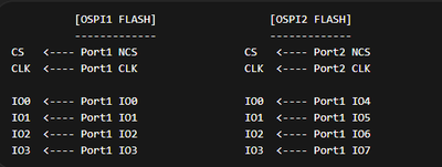

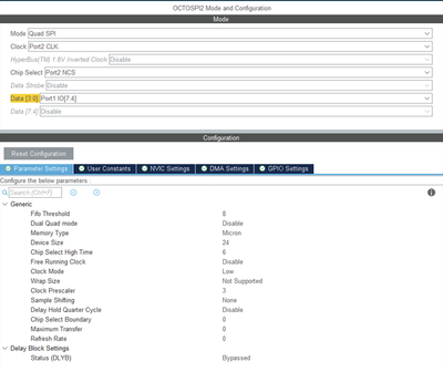

Is it possible to use two OSPI with below configuration.  I can make this configuration in cubeMx but whiel debugging ospi1 is not working after ospi2 initialize.

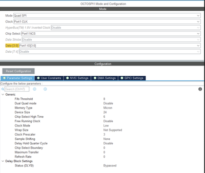

Hello @Epamuk ;
First of all thank you for sharing this behavior in the community.
Could you please look at this issue Solved: OCTOSPI: HAL_OSPIM_Config() - STMicroelectronics Community. I think you are experiencing the same issue.
To solve the issue could you please try to modify these code lines in octospi.c file
  sOspiManagerCfg.ClkPort = 1;
  sOspiManagerCfg.NCSPort = 1;
  sOspiManagerCfg.IOLowPort = HAL_OSPIM_IOPORT_1_LOW;
  if (HAL_OSPIM_Config(&hospi1, &sOspiManagerCfg, HAL_OSPI_TIMEOUT_DEFAULT_VALUE) != HAL_OK)
    Error_Handler();
  sOspiManagerCfg.ClkPort = 2;
  sOspiManagerCfg.NCSPort = 2;
  sOspiManagerCfg.IOLowPort = HAL_OSPIM_IOPORT_1_HIGH;
  if (HAL_OSPIM_Config(&hospi2, &sOspiManagerCfg, HAL_OSPI_TIMEOUT_DEFAULT_VALUE) != HAL_OK)
    Error_Handler();
by
  sOspiManagerCfg.IOHighPort = HAL_OSPIM_IOPORT_1_HIGH;
  sOspiManagerCfg.DQSPort = 1;
    Error_Handler();
  sOspiManagerCfg.DQSPort = 2;
    Error_Handler();
Please let me know if the issue is solved or not?
Thank you.
Kaouthar
Hello, my code was like (cubeMX created that)
    Error_Handler();
    Error_Handler();
I added only  sOspiManagerCfg.IOHighPort = HAL_OSPIM_IOPORT_1_HIGH; to OSPI1 init like below
    Error_Handler();
 and it works fine .
Thanks
KDJEM.1
Hello @Epamuk ,
Glad to know that the issue is solved.
This issue is already reported internally to STM32CubeMX for more investigation and fixing.
Internal ticket number: 203289 (This is an internal tracking number and is not accessible or usable by customers
