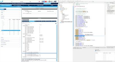

When configuring the LTDC Layer Settings for an STM32N6 chip in CubeMX, the Layer 0 - Color Frame Buffer Start Address is missing:
This parameter is available with other chips, such as STM32F750:
Ghofrane GSOURI
Hello @Pantomime
Your contribution is much appreciated.
I confirm this GUI limitation on STM32N6: the LTDC Layer Settings do not show the “Layer 0 - Color Frame Buffer Start Address” field, although the generated code still includes FBStartAdress.
A ticket #0062332 has been escalated to dev team for resolution.
I will keep you posted with updates.
Thx
Ghofrane
