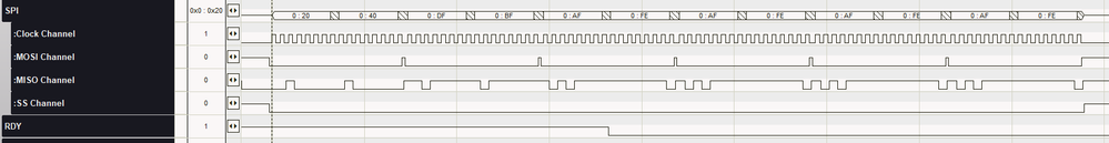

Here is a snip of the spi lines with a logic analizer.
F103:
0693W00000Lw89GQAR.pngL462:
0693W00000Lw8ATQAZ.pngAny idea what the issue could be and how could I fix it?

After a more detailed investigation it seems the reason for this issue was the fact that the time between slave enable and the output of the clock signal was too short for STM32L462.
The linux master ran the clock 30ns after the ss pin was set to low.
After changing this time to 60ns everything looks better.
