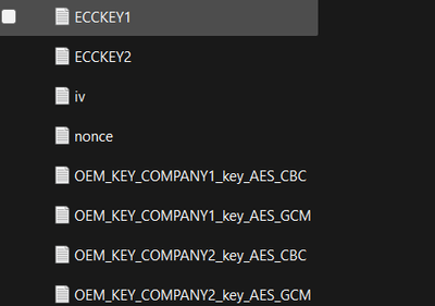

  • Duplicate both symetric and asymetric keys to support the second UserApp (i would preffer just the same set of keys for both) i just duplicated the files and change the names.

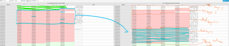

when i compile SECcore & SBSFU for two sets of identicall keys i was expecting duplicated flash memory content, but it seems prepareimage.py modifies nonce.bin each time is called? anyhow, it creates different key.bin for the same keys
