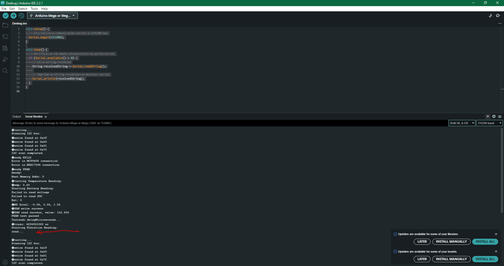

I'm developing a vibration and temperature sensor solution for industrial machinery.
Previously, my system was equipped with Atmega 328p chips, but it has now been upgraded to an STM32LO53C8T8 chip.
The circuit has a LoRa radio for sending signals to the gateway, a KX122-1037 accelerometer, a MCP9808 temperature sensor, a MAX17048 battery sensor and a MB85RC FRAM. I connected the TX pin to the arduino Mega to get a DEBUG display on the arduino IDE's serial monitor.
I assembled a PCB with the wiring diagram in the attached image, and it worked well for programming the microcontroller. However, I started to experience some problems when executing the code.
  • Firstly, my code is only executed by the chip when the system finishes uploading and resets it. I added an external 10K pull-up resistor to the chip's reset (which wasn't on the PCB). Now I can run the code whenever I pulse GND on the pin. However, it should run whenever the system is connected to power, which is not happening.
  • Secondly, my code is crashing in the accelerometer reading loop, basically I added a loop that reads the accelerometer 2048 times during one second, spacing the readings with a microsecond delay calculated in the setup method. The loop code runs well up to about 30 samples and then stops. I've tested the delay separately and apparently it works. And I've tested the loop with no other code in it, just the delay, and the same error happens.
Full Codes: https://gist.github.com/MatheusMarkies/a85b8288ed40ea9962f3d91e22202695

	DEBUG_PRINT("read...\r\n");

void setup() {
    DEBUG_PRINT("Starting...\r\n");
    I2C_Scan();
    if (KX122_Init(&hi2c1) != HAL_ERROR)
        DEBUG_PRINT("Ready KX122\r\n");
    else
        DEBUG_PRINT("Error in KX122 connection\r\n");
    if (MCP9808_Init(&hi2c1) != HAL_ERROR)
        DEBUG_PRINT("Ready MCP9808\r\n");
    else
        DEBUG_PRINT("Error in MCP9808 connection\r\n");
    if (MAX17048_Init(&hi2c1) != HAL_ERROR)
        DEBUG_PRINT("Ready MAX17048\r\n");
    else
        DEBUG_PRINT("Error in MAX17048 connection\r\n");
    if (FRAM_Init(&hi2c1) != HAL_ERROR)
        DEBUG_PRINT("Ready FRAM\r\n");
    else
        DEBUG_PRINT("Error in FRAM connection\r\n");
    DEBUG_PRINT("Ready!\r\n");
    FRAM_InitMetadata(&metadata);
    char buffer[50];
    snprintf(buffer, sizeof(buffer), "Next Memory Adds: %d\r\n", metadata.nextFreeAddress);
    DEBUG_PRINT(buffer);
    package_factor = 3 * ceil((float)(SAMPLES) / (float)TRANSMISSION_DATA_PACKAGE);
    data_sender_period = round(1000 * ((float)DATA_TRANSMISSION_PERIOD / (float)package_factor));
    sampling_period_us = round(1000000 * (SAMPLES / (float)ACC_DATA_RATE));
    acc_sample_factor = floor((float)ACC_DATA_RATE / (float)SAMPLES);
    sizeInBytes = FRAM_MEMORY_SIZE;
    FRAM_Format(&hi2c1, &metadata);
    DEBUG_PRINT("Starting Temperature Reading:\r\n");
    double temp;
    MCP9808_ReadTemperature_LowPower(&temp);
    char bufferTemp[50];
    snprintf(bufferTemp, sizeof(bufferTemp), "Temp: %.2f\r\n", temp);  // Usar %.2f para imprimir double
    DEBUG_PRINT(bufferTemp);
    DEBUG_PRINT("Starting Battery Reading:\r\n");
    int16_t bat = 0;
    readBatteryData(&bat);
    char bufferBat[50];
    snprintf(bufferBat, sizeof(bufferBat), "Bat: %d\r\n", bat);
    DEBUG_PRINT(bufferBat);
    Vibration vibration = KX122_ReadAccelData(&hi2c1);
    char bufferVib[50];
    snprintf(bufferVib, sizeof(bufferVib), "RMS Accel: %.2f, %.2f, %.2f\r\n",
             vibration.x, vibration.y, vibration.z);  // Usar %.2f para imprimir double
    DEBUG_PRINT(bufferVib);
    // Teste de escrita e leitura da FRAM
    float test_value = 123.456f;
    float read_value = 0.0f;
    uint16_t test_address = 0x0000;
    if (FRAM_WriteFloat(&hi2c1, &metadata, test_address, test_value) == HAL_OK) {
        DEBUG_PRINT("FRAM write success\r\n");
        if (FRAM_ReadFloat(&hi2c1, test_address, &read_value) == HAL_OK) {
            char buffer[100];
            snprintf(buffer, sizeof(buffer), "FRAM read success, value: %.3f\r\n", read_value);
            if (fabs(test_value - read_value) < 0.001f) {
                DEBUG_PRINT("FRAM test passed\r\n");
            } else {
                DEBUG_PRINT("FRAM test failed: values do not match\r\n");
        } else {
            DEBUG_PRINT("FRAM read failed\r\n");
    } else {
        DEBUG_PRINT("FRAM write failed\r\n");
    DEBUG_PRINT("Testando delayMicroseconds...\r\n");
        uint32_t start_test = micros();
        delayMicroseconds(1000000);  // 1 segundo
        uint32_t end_test = micros();
        char bufferDelay[50];
        snprintf(bufferDelay, sizeof(bufferDelay), "Atraso: %lu us\r\n", end_test - start_test);
        DEBUG_PRINT(bufferDelay);
    DEBUG_PRINT("Starting Vibration Reading:\r\n");
        writeVibrationInformation();

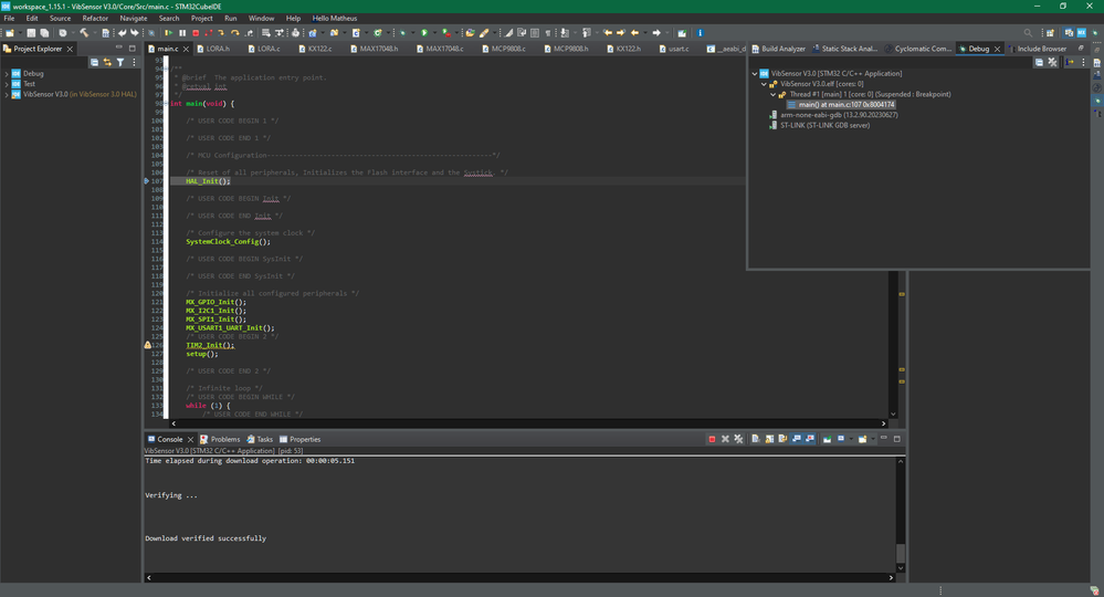

I added the changes to the delay and ran the Debug.
In the STMCube debug mode, it is stuck on HAL_Init.
In Run mode, it runs up to the same delay point and doesn't go any further.
So step into that function to see where, exactly, it's getting stuck.

Why is your debug output corrupted at start of line? I saw this once when I was multiplexing a pin between SPI and UART modes, and was not respecting the timing for CS for the other chip when switching.
You should look into it - later.
- If someone's post helped resolve your issue, please thank them by clicking "Accept as Solution".
- Please post an update with details once you've solved your issue. Your experience may help others.
Well, as I'm using the Mega which is powered by a 5V voltage, I believe it's corrupted by the difference in power supply voltages and the lack of a level shifter in the UART.
How can I debug it? This function is defined in a file called "stm32l0xx_hal.c".
The IDE debug is only showing what it executes in main.c
I don't think so. But let's not get off track here.

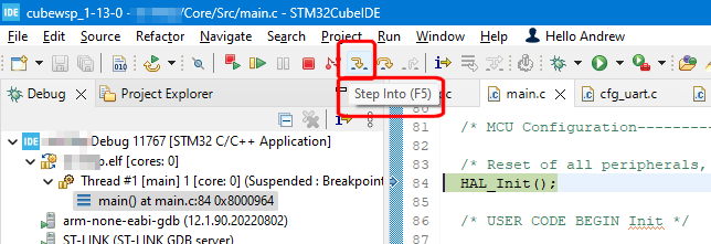

Use the 'Step Into' button:

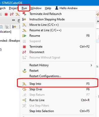

Also available on the 'Run' menu:

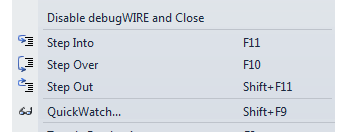

It's a pretty standard debugger feature - Microchip's MPLAB and Microchip Studio both have it:
https://developerhelp.microchip.com/xwiki/bin/view/software-tools/ides/x/debugging/debug-toolbar/
https://onlinedocs.microchip.com/pr/GUID-ECD8A826-B1DA-44FC-BE0B-5A53418A47BD-en-US-12/index.html?GUID-1BC19729-74D5-426D-9390-56CC86357F2F
