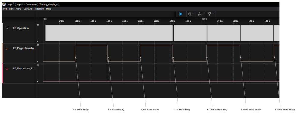

I am running a bluetooth application using freeRTOS on a Nucleo-WB55 (STM32WB55RG). I am in the process of implementing Emulated EEPROM (X-Cube-EEPROM) to store som data.
After implementing eeprom emulated in a ble_heartrate_freertos example I have had problems understanding the execution of the Emulated EEPROM operation after a pagetransfer + cleanup (obs. for simplicity I use EE_CleanUp here)

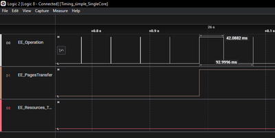

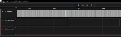

Without BLE activated (in SingleCore mode) EEPROM Emulated write and pagetransfer+cleanup looks just fine:
Pagetransfer + cleanup takes ~40-50ms

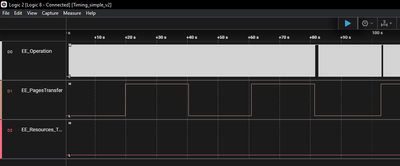

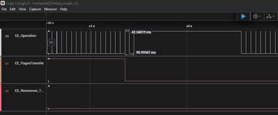

With BLE activated (in DualCore Mode) the following EEPROM operation occupies much more time than expected:
Pagetransfer + cleanup still takes ~40-50ms, but a long delay is introduced in the next EEPROM operation:
Here is an example of the additional delay introduced in the following EEPROM (after a pagetransfer + cleanup) operation:
Here is the code:

2025-01-23 12:42 AM
Dear Nikolaj,
I believe justification of your behavior is in synchronization between cores during flash access as described in AN5289, chapter 4.7.1 CPU2 timing protection. Before flash erase, CPU1 shall send command SHCI_C2_FLASH_EraseActivity (ERASE_ACTIVITY_ON) and wait for Sem7. As CPU2 is sleeping, Sem7 will be released by CPU2 during next connection/advertising event. This may cause delay up to size of connection/advertising interval, delay may change depending how long before CPU2 wakeup CPU1 start waiting for Sem7 (as your picture is showing).
Would this hypothesis fit your connection/advertising interval? Could you please verify your CPU1 is really waiting for Sem7?
Thank you, best regards,
Lubos
2025-02-11 5:52 AM
Hello @Lubos KOUDELKA,
You are right CPU1 is waiting on Sem7 (tested by toggling a GPIO). This happens due to a page erase after a page transfer. Is It possible to wake cpu2 from sleep to make it hand over the semaphore before it wakes by the connection/advertising event.
Another issue which bothers me is that write operations also vary in length. From what I understand cpu1 should request the sem2 & sem7 both when it needs to write data and when it needs to make page transfers (as descriped in 4.7.1 (through the algorithm shown in Figure 10). But I do not see long wait times for semaphore7 when cpu1 writes variables in flash, only when it needs to make pagetransfer and therby erase a page.
How can this be?
