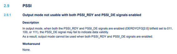

Best answer by KDJEM.1
Hello @Michal Dudka ;
First of all, I apologize for my late reply and thank you for sharing this interesting use case and bringing this issue to our attention. This is a PSSI errata.
You can find in the Erratasheet ES0596 - Rev 8, the PSSI errata description:
You can expect the same behavior in all STM32MCUs available on the market and have PSSI interface: STM32H7R/S, STM32U5, STM32H5, STM32H7A/B...
Thank you.
Kaouthar

KDJEM.1
KDJEM.1Best answer
January 8, 2026
Thank you.
Kaouthar
STOne-32
January 8, 2026
Dear @Michal Dudka ,
Thank you for identifying this new silicon erratum and for your thorough follow-up in narrowing down the use case. Your efforts enabled our teams to confirm the issue, which is now published.
As there is no workaround, future STM32 microcontrollers will benefit from an enhanced version of the same PSSI peripheral as a result of your contribution.
We would like to offer you a small symbolic gift: any STM32 board of your choice from our e-store. Please let us know your preferred board or STM32 series.
Thank you also to @KDJEM.1  for the follow-up.
