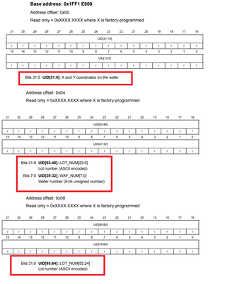

I need to develop a unique serial number for one of our products that will go into production soon. I'd rather use the UID that is built into the STM32H7A3 chip but I have some questions.
I understand that it is a 96bit value that I can read from the chip but I'd rather not have to use such a long and unwieldy number.
I looked at page 2920 of the manual RM4055 but it doesn't really tell me which byte is for which variable (Lot, Wafer, Die, etc).
This number will need to fit onto our 7" display as well as the serial number label on the product's back side.
Has anyone else been able to figure out the UID format?

‎2024-03-11 6:32 AM
Hello @RCooke88 ,
Following are what we can provide as UID structure information:
0x8FFF800 - 16 bits -> X coordinate (integer) 0x8FFF802 - 16 bits -> Y coordinate (integer)
0x8FFF804 - 8 bits -> Wafer number (integer) 0x8FFF805 - 8 bits -> LOT_ID0 (ascii code) 0x8FFF806 - 8 bits -> LOT_ID1 (ascii code) 0x8FFF807 - 8 bits -> LOT_ID2 (ascii code) 0x8FFF808 - 8 bits -> LOT_ID3 (ascii code) 0x8FFF809 - 8 bits -> LOT_ID4 (ascii code) 0x8FFF80A - 8 bits -> LOT_ID5 (ascii code) 0x8FFF80B - 8 bits -> LOT_ID6 (ascii code)
It's the same as STM32H743.
I'm pushing internally to add these details in RM0455.

- UID[31:0]: X and Y coordinates on the wafer expressed in BCD format
- UID[39:32]: WAF_NUM[7:0] Wafer number (8-bit unsigned number)
So you get a 40bit number, just for this chip. (is 12 digits )

SofLit,
I did open up a new thread and I tagged you (it's this thread). RM0433 is the manual for STM32H742 and '43 chips. We're using the STM32H7A3 chip. Both of the manuals (RM4033 and RM4055) show pretty much the same information. Neither one adds any information on which byte is what variable (Lot, Wafer, Die, etc.).

No. RM0433 shows wafer and lot information. Please check again.
PS: we cannot provide more details than what was provided in RM0433
Long term they are all variable, and collectively they are unique.
The question is how variable, or what's the scope of a particular variable. The X, Y sounds like it could be an offset, not an index. It would get into what are the dimensions of the individual dies, and how many are on a wafer at a given fab.
Figure the wafers out of Crolles (VQ) are 300mm / 12", die likely smaller than 5x5mm, so >3000 die per wafer
