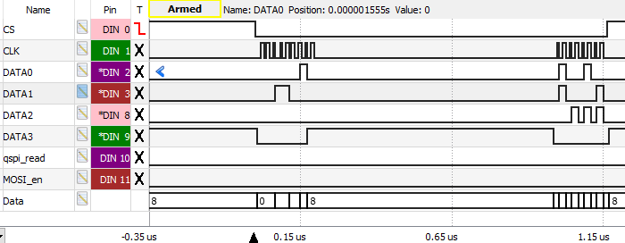

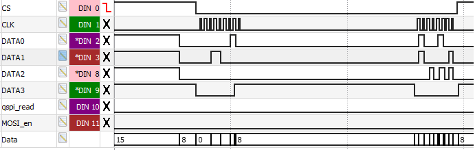

As result, I see by Logic Analyser the next picture:
The first burst of clocks corresponds to the transmission if Command, the 2nd - to the Data. The gap between two bursts  is about 0.76 mks in the case of using of HAL_QSPI_Transmit_IT and 1.5 mks in case of HAL_QSPI_Transmit which is somehow strange.
But the main question how I have to organize QSPI transmission without delay between Command and Data?

Ok, I have to repeat test. Here is results:

Logic Analyser:
Inspect HAL_QSPI_Command source and construct a multi-byte variant
I tried to combine the HAL_QSPI_Command and HAL_QSPI_Transmit functions in a single function without additional conditional checks or __HAL_LOCK like functions use.
The result is the same - I see the gap between Command and Data sections during QSPI transmission.
