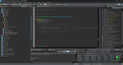

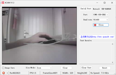

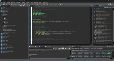

With DCMI (with DMA) and USART only 1.5FPS, why is the frame rate really low?
3 REPLIES 3
Probably because the bandwidth of.the UART is very low?
I set the baudrate to 912600, and the camera output is JPEG, so I don't think USART is too slow.
