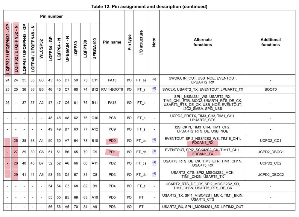

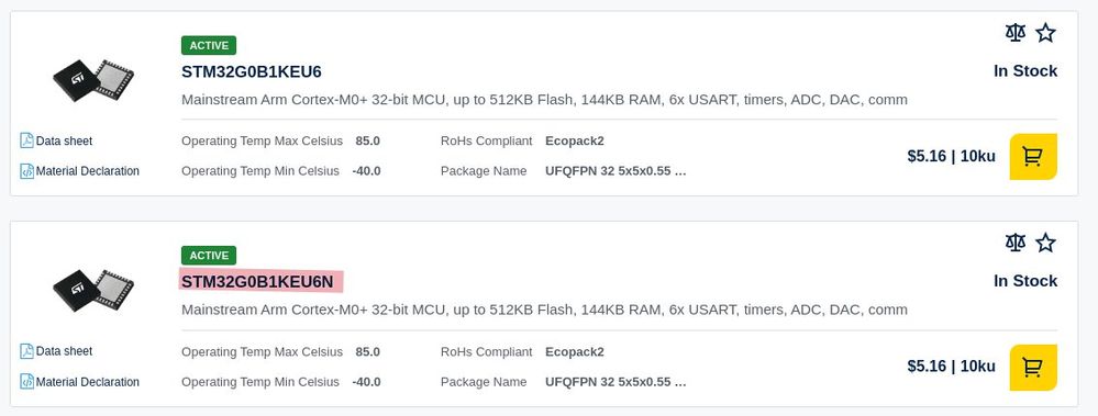

@EniRot99 wrote:
Given that these specific pins (PD0 and PD1) are not available on my microcontroller, I am curious to know:
Are you sure about this? The DS indicates there are two 32-pin variants, and one of them does have PD0/PD1.
And from the ST direct store:

> Can the internal bootloader still be utilized without these pins?
No. Only pins and peripherals listed in AN2606 can be used.
> Are there alternative pins that can be used for the bootloader functionality on this microcontroller?
No
> If the above options are not feasible, does this mean that the bootloader feature is not available for the STM32G0B1KEU6?
Correct.

> This is strange. If ST knows it prunes FDCAN1 on some packages, why would they write the boot loader to use FDCAN1 instead of FDCAN2?
This chip still has FDCAN1 and pins that can use it, just not the pins that the bootloader uses. There are thousands of chips and much fewer bootloader versions, it's not going to be possible to micromanage every case.
