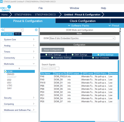

Hi everyone,
I'm trying to interface a DVP camera (like OV5640) with the STM32F469I-DISC0 board using the DCMI peripheral in 8-bit parallel mode.
What I have:
- The camera is configured and outputs data correctly via I2C.
- I'm using bare-metal code (no HAL or CubeMX), and SDRAM + USART debug are working.
- DCMI pins are being mapped as per the STM32F469 reference manual.
- I verified that I can access and remap the following DCMI pins:
- D0 – available
- D1 – available
- D2 – available
- D3 – available
- D4 – not available(e.g., PE5)
- D5 – available
- D6 – available
- D7 – available
- HSYNC, VSYNC, PCLK – available
Problem:
- DCMI_D4 is not brought out on any connector** on the DISC0 board. It's internally routed to LCD or unused.
- I checked the board schematic and there’s no easy way to solder to it either.

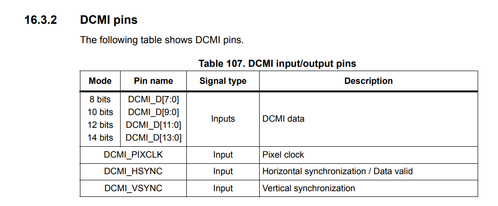

Hello @sanjaykrishnegowda and welcome to the community;
According to reference manual the DCMI main features are:
• 8-, 10-, 12- or 14-bit parallel interface
• Embedded/external line and frame synchronization
• Continuous or snapshot mode
• Crop feature
• Supports the following data formats:
– 8/10/12/14-bit progressive video: either monochrome or raw Bayer
– YCbCr 4:2:2 progressive video
– RGB 565 progressive video
– Compressed data: JPEG
7 bits mode is not supported.
Note that the DCMI_D4 is available on PE4, PC11 and PH14 pins.

Edit : I soldered the SDCard pin and have been using that for DCMI . Looks like that is the only way.
