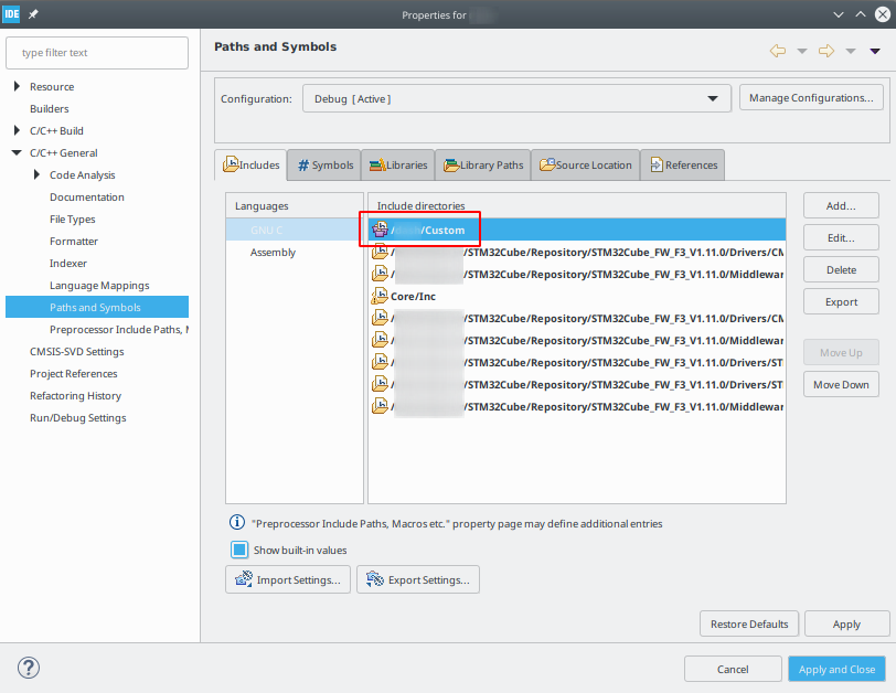

I came to the same issue, and if you want the short answer, it's not supported (at least up to the current version of STM32CubeIDE - v1.3.0).
Has been fixed in STM32CubeIDE v1.4.0, see answers below.
My current workaround is to copy the _hal_conf.h file to some other directory, modify it to my liking and add its path to the top of the Include directories list. I also needed to set the Is a workspace path option to keep the code generator from changing its order.
Obviously, when you're doing any major reconfiguration (enabling/disabling peripherals etc.) you need to manually update your customized variant, which isn't ideal.

I've expanded on my previous solution by using user templates feature to patch the _hal_conf.h file with USER CODE sections.
This allows us to manually manage REGISTER_CALLBACKS section while the rest is managed by the code generator.
