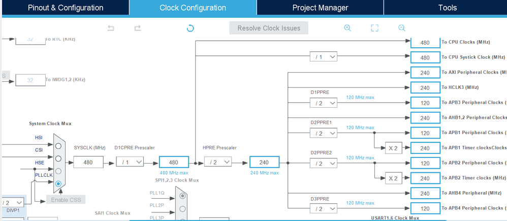

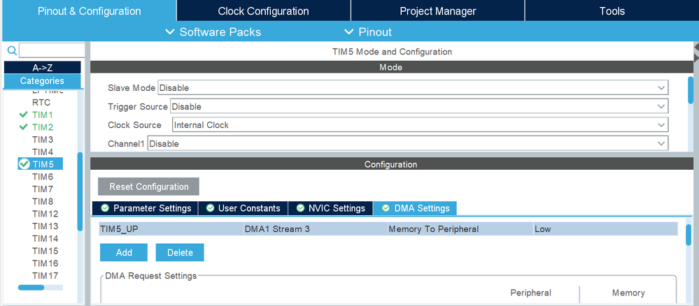

Timer 5 is configured for 10 MHZ speed to trigger the DMA. In the DMA transfer (Memory to Peripheral) we are using the GPIO PB4 for clock generation. Clock is generated but it is not proper. We would like to the know the reason for it and any precautions/setting we have to follow to get the proper clock.

	//Timer Clock 240 MHZ .//Set 20 MHZ speed
	htim5.Init.Prescaler=0;
	htim5.Init.Period = 12-1;

	__HAL_TIM_ENABLE_DMA(&htim5, TIM_DMA_UPDATE);
	__HAL_TIM_ENABLE(&htim5);

	dataTransferStatus = HAL_DMA_Start_IT(&hdma_tim5_up, (uint32_t)gpioFirstBuf, (uint32_t)&GPIOB->ODR, 24);

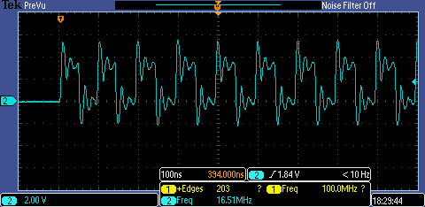

Captured picture using CRO.
Andrew Neil
"Clock is not observed properly"
So observe it properly, then! ;p
Seriously,
  1. How, exactly, are you generating this?
  2. How, exactly, are you observing it?
  3. What are you seeing?
  4. What is "wrong" about what you are seeing?
It would help to see your code, and a 'scope trace of the output (if possible, get a screen capture - not a photo); maybe also a good, clear, in-focus photograph of your setup.
Is there a particular reason for using DMA rather than, say, a timer ... ?
Ok, what's your primary objection here? The frequency, the ringing?
Make sure to use 10x mode on the probe as frequency increases.
Driving into no-load, perhaps significantly back off the GPIO's SPEEDR setting for slew-rate from INSANELY_FAST to MEDIUM or HIGH.

2) Timer Source Clock 240 MHZ and linked to DMA (Memory to peripheral) which will transfer the data on the GPIO pins.
3) Setting the timer 20 Mhz using the period (set period 11).
4) On timer elapse event generated to DMA transfer the data on GPIO Port.

1) Up to 5Mhz (set period 23) the waveform is ok..
2) For 10 Mhz (set period 11), the waveform is ringing (observe the same in the above shown picture)
3) To achieve 20 Mhz(set period 5) frequency on the GPIO pins . We are observing the 10Mhz waveform is ringing.
If we set more than 10 Mhz , then there is no change in the waveform frequency and only 10Mhz waveform is ringing.

@Rajesh Kannan​ "Our objection is achieving highest frequency and ringing."
Eh?? You want the highest ringing?!?! :o
Surely, for highest frequency, a timer direct to the pin is the way to go?
Ringing is a result of the capacitance & inductance of the wiring - you can't fix that in software!
(well, apart from adjusting slew rate, as @Community member​ said).
Also be sure that you're using a decent scope probe, and that it is properly compensated, properly grounded, etc.
Again, photos of your setup would help,
It's ringing because too much energy is being dumping into the trace. This could be further exacerbated by the point in the trace you're probing, along with how effective the grounds, and ground connections are.
Additionally to all this, on the Disco, traces may be not optimal and some on-board circuitry may be already connected to given pin.
> For high-speed pattern output, consider the FMC bus into a latch.
Or maybe a timer. In any case, use as much hardware as possible, avoid bit-banging by software. The 'H7 is very inappropriate for accurate real-time operation, probably surprisingly for many.

It has resolved the ringing issue with proper test setup.
