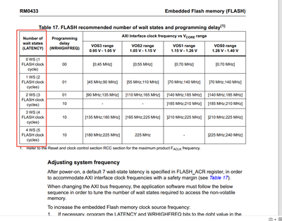

Hello @ketlen
Please refer to the table "FLASH recommended number of wait states and programming delay" in the reference manual to set the good flash latency.
Saket_Om
According to the table provided in the reference manual, if the AXI peripheral clock frequency is 80 MHz, the voltage range is VOS0, and the Flash latency at this time should be 1WS. When the code is generated by STM32CubeMX, the Flash latency is FLASH_LATENCY_1, which is consistent with the manual. However, during the actual test, it was found that the Ethernet still could not operate normally. Only when I modified the Flash latency to FLASH_LATENCY_2 or FLASH_LATENCY_3, could the Ethernet operate normally.

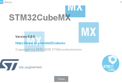

The current version of STM32CubeMX being used for this project is 6.8.0, and the version of the HAL library being employed is 1.9.1.
