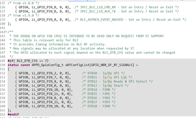

Mine goal is to find out more details, as Reason 0x8 seems not to be accurate. There are debug pins, might that help to find a root cause.

Filip, situation is as follows-> both HopeRF and Flutter (Android) have identical issue in communication to write 21B value to characteristic on STM32WB. The issue of both sources, points to the potential issues with STM32. I did update the BLE stack (1.18 -> 1.21), changed parameters like MTU, interval and so on. My question is how to investigate situation further using more sophisticated tools like attached on the picture, e.g. using scope. Or any other BLE parameters that I could play with?
