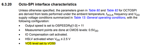

The datasheet DS13311 rev. 5 defines the max. SPI clock for the OCTOSPI only for VOS0, what is the max. SPI clock for other Power Scale settings (I'm planing to use VOS1)?

To close this:
I have got an answer to my case from ST:
In you case at VOS1, the performance can be degraded by up to 5% compared to VOS0.
Case closed
Martin

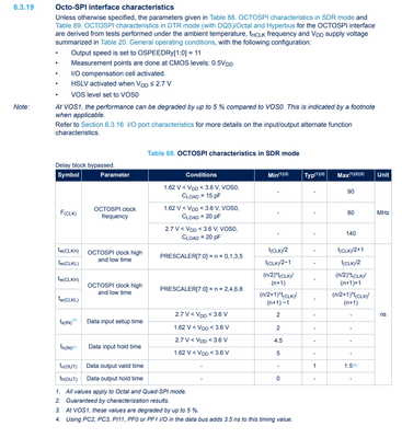

To close this:
Case closed
Martin
Dear @MHoll.2 ,
Thank you very much to be back to our Community with the answer from our colleagues in charge of the R&D :
Datasheet - STM32H7B0xB - 32-bit Arm® Cortex®-M7 280 MHz MCUs, 128-Kbyte Flash memory, 1.4-Mbyte RAM, 46 com. and analog interfaces, SMPS, crypto
As it is the using the same technology with STM32H7A/B  we can apply the same
and it would be an opportunity to update the H725/35 Datasheets .
Ciao
