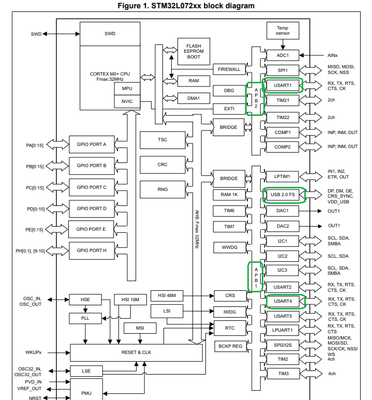

Here is what I've observed:
- If I set USART4 to 31250 baud, USB does not work (enumeration fails)
- If I set USART4 to 115200 baud instead, USB works fine.
- If I use USART1 instead of USART4, USB works fine, even when the speed is set to 31250.
I suspect there is some difference in clock source / implementation between USART1 and USART4 based on the fact that CubeMX only shows USART1 with a configurable clock source / source mux. Is that the case?

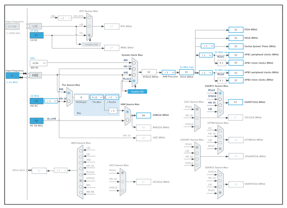

Dear @Delaney ,
Thank you for sharing ! Indeed your hypothesis seems interesting on right clocks between different blocks - USB, System , APB1 and APB2 :
If possible to let us know your Clocks settings ?
Thanks again.

Thank you for the reply.
Here are my clock settings:
void SystemClock_Config(void)
RCC_PeriphCLKInitTypeDef PeriphClkInit = {0};
__HAL_PWR_VOLTAGESCALING_CONFIG(PWR_REGULATOR_VOLTAGE_SCALE1);
RCC_OscInitStruct.OscillatorType = RCC_OSCILLATORTYPE_HSE;
RCC_OscInitStruct.HSEState = RCC_HSE_ON;
RCC_OscInitStruct.PLL.PLLSource = RCC_PLLSOURCE_HSE;
RCC_OscInitStruct.PLL.PLLMUL = RCC_PLLMUL_12;
RCC_OscInitStruct.PLL.PLLDIV = RCC_PLLDIV_3;
Error_Handler();
RCC_ClkInitStruct.APB1CLKDivider = RCC_HCLK_DIV1;
RCC_ClkInitStruct.APB2CLKDivider = RCC_HCLK_DIV1;
if (HAL_RCC_ClockConfig(&RCC_ClkInitStruct, FLASH_LATENCY_1) != HAL_OK)
Error_Handler();
PeriphClkInit.PeriphClockSelection = RCC_PERIPHCLK_USART1|RCC_PERIPHCLK_USB;
PeriphClkInit.Usart1ClockSelection = RCC_USART1CLKSOURCE_PCLK2;
PeriphClkInit.UsbClockSelection = RCC_USBCLKSOURCE_PLL;
if (HAL_RCCEx_PeriphCLKConfig(&PeriphClkInit) != HAL_OK)
Error_Handler();

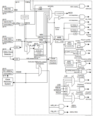

‎2024-08-06 11:23 AM
Dear @Delaney ,
Thanks for sharing, may be this sentence is key "If I set USART4 to 31250 baud, USB does not work (enumeration fails)" How USB enumeration can fail due to USART4 baud rate at 31250 instead of 115200 ?
may be to check how the MIDI Class and example is setup at application level and clocks synchronization. Very interesting case.
