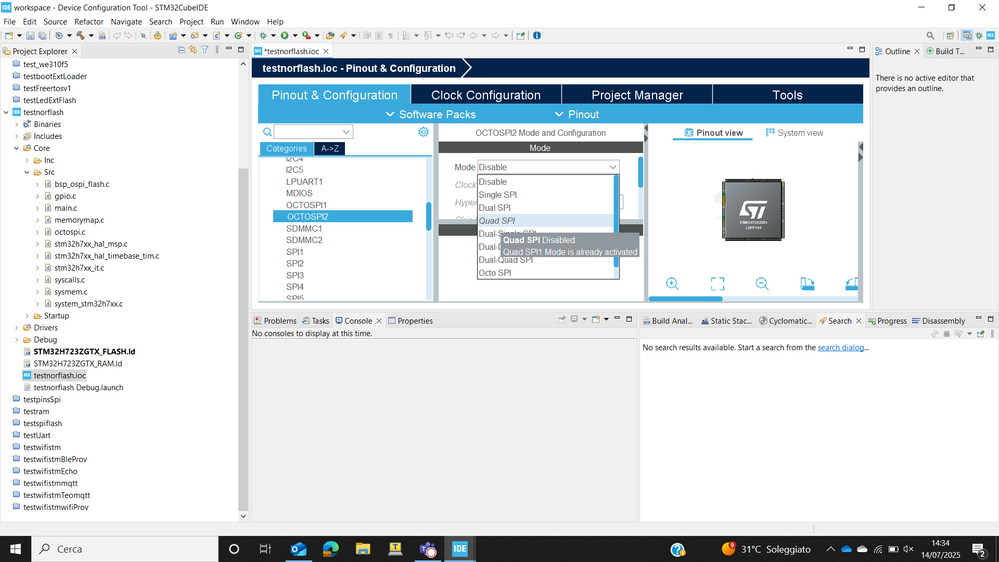

With the last versione of STM32CUBEIDE Version: 1.19.0 i can't configure the OCTOSPI as QUADSPI

Hello @franckngatcha;
The issue is fixed in STM32CubeMX 6.16.0 version.
Thank you.
