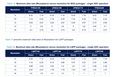

I'm confused about the maximum data transfer of the STM32H723ZG. The overview says:
  • 2×16-bit ADC, up to 3.6 MSPS in 16-bit: up to 18 channels and 7.2 MSPS in double-interleaved mode
Then the 'AN5354 -  Getting started with the STM32H7 Series MCU 16-bit ADC' also mentions these data rates for the H7 series but not specifically the STM32H723ZG. This application note also specifies a huge discrepancy between different packages and rates:
Then, assuming these numbers correspond to the direct channels, what are the data rates for the fast or even slow channels?
End of confusion : maximum data rate is always same, as in ds : up to 3.6 MSPS in 16-bit ...etc.
The problem is: what will be the real/effective resolution or precision you get then ?
And THIS depends on many factors : setting of ADC sampling time, input impedance at pin, length of line/wire to this point (so also size and type of its package ), internal resistance of the analog path + switches to that pin ("slow" or fast etc.),
noise on Vref , noise on chip GND /AVSS , layout of board and routing, activity of cpu and next pins (stray in spikes), ...etc.

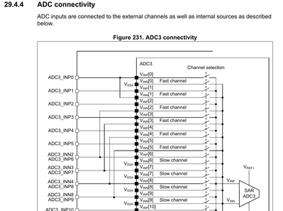

>CubeMX doesn't clearly indicate which ADC channels are direct
Right, you have to look in rm for your cpu, to see this in detail:
CubeMX cannot know, what you want to connect and what real resolution will be possible then,
vs what you expect. It shows just, what can be used/connected to a pin .
 Whether this makes sense for the intended design , or not, is your decision. :)
