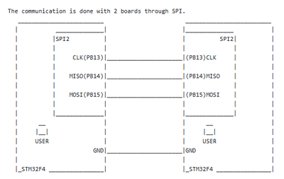

You can inspire from the example provided in the F4 cube package here.
I'm sorry, but this sample is completely useless.
My main problem is syncronized packet transfer, which requires more complex solution.
Maybe you have another version(s)?
