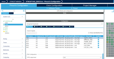

Performance testing can be done using the GPIO pins designated with the following signals: VSYNC_FREQ  - Pin PB4(D3), RENDER_TIME - Pin PC6(D1), FRAME_RATE  - Pin PC7(D0), MCU_ACTIVE  - Pin PG6(D2)
 It seems we are already using the PB4 pin.
What you can do it to use another pin or to change assign VSYNC_FREQ to another free pin.
To assign VSYNC_FREQ to another pin, open STM32CubeMX and check here:

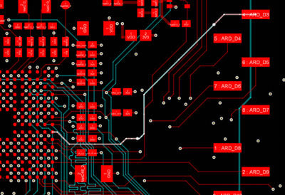

I also checked the MB1191 design files, BGA pin A9 / PB4 / I2S2_WS is exclusively attached to the arduino header D3 pin:

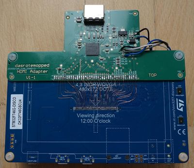

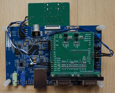

I am using a custom Arduino shield to use I2S
