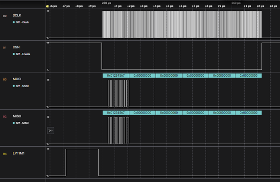

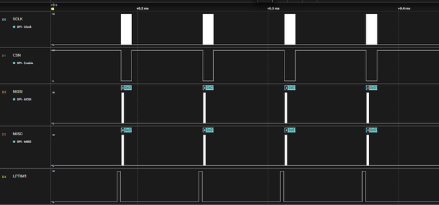

Thanks for your reply! I will try to elaborate
When Im using pSyncConfig.RequestNumber = 4, I am getting the expected behavior. At the current stage I am looping back MOSI to MISO and I am reading what I am sending. This is happening at the rate of LPTIM sync event at 16 kHz.
After setting up the SPI, DMA and LPTIM I am using this function:

From oscilloscope:

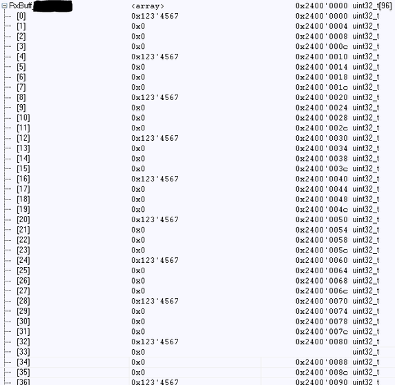

Live watch of the rxBuffer

When I adjust the pSyncConfig.RequestNumber = 6.
I see in the oscilloscope that the readout is occuring at HW level:

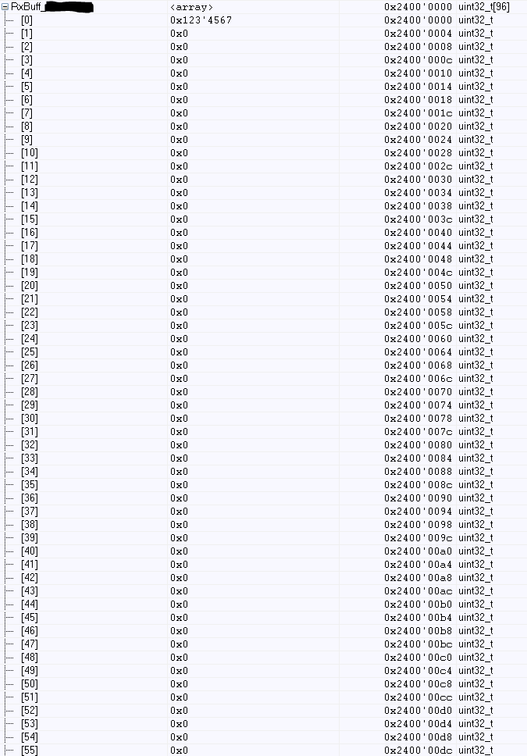

In the live watch the buffer is only receiving the first 4 words:
In the SPI SR the peripheral is flagging overrun (OVR). There are no error flags in the ISR register of the DMA peripheral.
Is there a way I can change the settings in the DMA or SPI to have the DMA handle the data before overrun?
