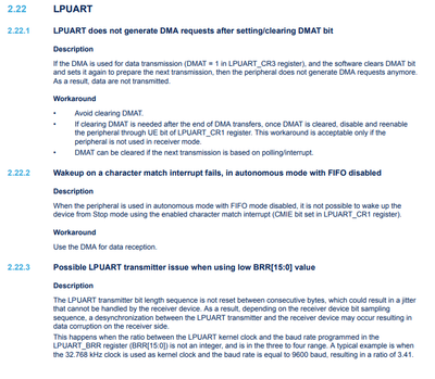

Did you look at the STM32U575 errata sheet and check if you have the known limitation related to the LPUART that could be causing this issue.

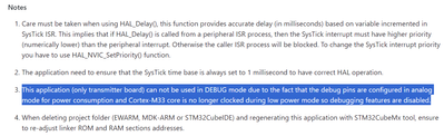

I enabled the debug by removing the init of PA13 and PA14.
=> This application (only transmitter board) can not be used in DEBUG mode due to the fact that the debug pins are configured in analog mode for power consumption and Cortex-M33 core is no longer clocked during low power mode so debugging features are disabled.
Please check this point as described in the readme file.
Thanks
Imen
2025-01-20 1:56 AM
I know that but with the unmodified code, the blue led never turn on.
And with debugger, the code crash before going into low power.
Would it be possible to have a binary file so i can know if i have a problem with my hardware or with my compilation ?
