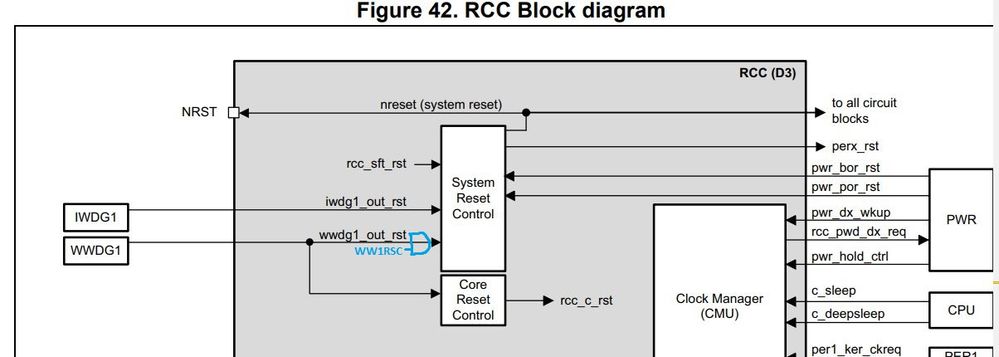

The STM32H753 reference manual section 8.4.2 Figure 43 shows that a watchdog reset will cause a transition on the external NRST pin, as will a software reset.

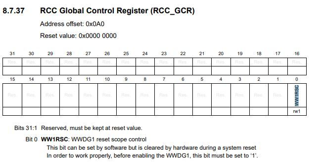

The RCC_RSR_WWDG1RSTF bit is not touched in the HAL libraries either except in LL_RCC_IsActiveFlag_WWDG1RST to check its status. So probably also a CubeMX bug if you try to use WWDG1.
Thanks for taking the time to look though the RM. I did see that note a few days ago. I reviewed through code and was sure that bit was enabled by the watchdog MSP init function. I just looked again through the STM32 cube MX generated code and it wasn't. Also, saying "its behavior is not guaranteed" is a bit vague!
Anyways I did find this in the HAL library which clearly explains the situation!

So, I changed the code to set that bit and I can confirm that the watchdog reset does indeed now cause an external reset. So, the overall problem here was a combination of:
  1. Me misinterpreting the WW1RSC bits functionality and possibly making an assumption that the STM32CubeMX generated code would have enabled the watchdog correctly.
  2. The reference manual not being completely clear that the WW1RSC bit connects up the system reset to watchdog reset. It actually does say so though, see below.
  3. STM32CubeMX not actually setting this bit when it is required to be set.

Reference manual says WW1RSC bit must be set in a roundabout way:
The bit description for WW1RSC does not actually say what it does.0693W000000X1oDQAS.jpg
A picture says a thousand words. This would have made it so much more obvious!0693W000000X1oSQAS.jpg

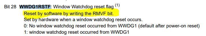

The WWDG1RSTF flag is not allowed to be written by software. You can read it to see the cause of a reset, but must clear it by setting the RMVF bit. HAL provides the __HAL_RCC_CLEAR_RESET_FLAGS(); macro for this. And if (__HAL_RCC_GET_FLAG(RCC_FLAG_WWDG1RST) == SET) ... for reading.

The reason behind this bit becomes clear when cross-checking RCC_GCR with the H745/H747 RM as these devices are actually the same as the H743 (except that the M4 is disabled on the H743): If it is cleared, only the M7 is to be reset, not the M4.

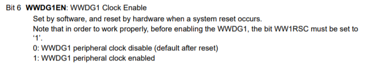

Besides to the "Caution" added in the RM and already mentioned in this discussion, we have the following description for WWDG1EN bit:
This said, it may remain not enough clear and requires farther explanation in RM. I'll raise internally other requests for documentation updates asked by Jan.

It would be great if the reference manual just stated what the WW1RSC bit does. E.g. WW1RSC must be enabled before enabling the WWDG1 to ensure a watchdog reset will cause a system reset rather than just a CPU reset. Or link to the WWRSC1 description and have that be clearer about its purpose.
