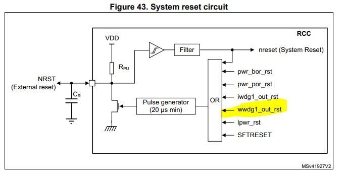

The STM32H753 reference manual section 8.4.2 Figure 43 shows that a watchdog reset will cause a transition on the external NRST pin, as will a software reset.
I have prepared an absolute minimal example showing that this is not the case. However, a software reset does for sure generate a transition on the NRST pin. The example lets the watchdog expire (about every 24ms) and reset the CPU. If you scope the NRST pin you will see it does not change state. A break point (or additional pin toggle) will confirm it is indeed doing a watchdog reset. If you uncomment the two lines noted in the example (main.c line 100) so a software reset occurs before watchdog timeout you will see that the NRST pin cycles every ~12 ms as per attached scope picture.

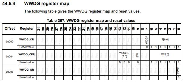

0693W000000WxAsQAK.jpgThere are not many options to control this watchdog, it is pretty basic. A counter, a window value, a prescaler, an early wakeup flag and an activation bit.

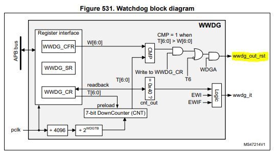

There are no WWDG option related bits according to a search. There is nothing in the reference manual suggesting there is anything to disconnect the reset output of the watchdog circuit from the reset circuitry. There is obviously something in there that disconnects it, but whether its an option or not...
These sections of the manual suggest WWDG reset causes a direct pin reset of the micro:

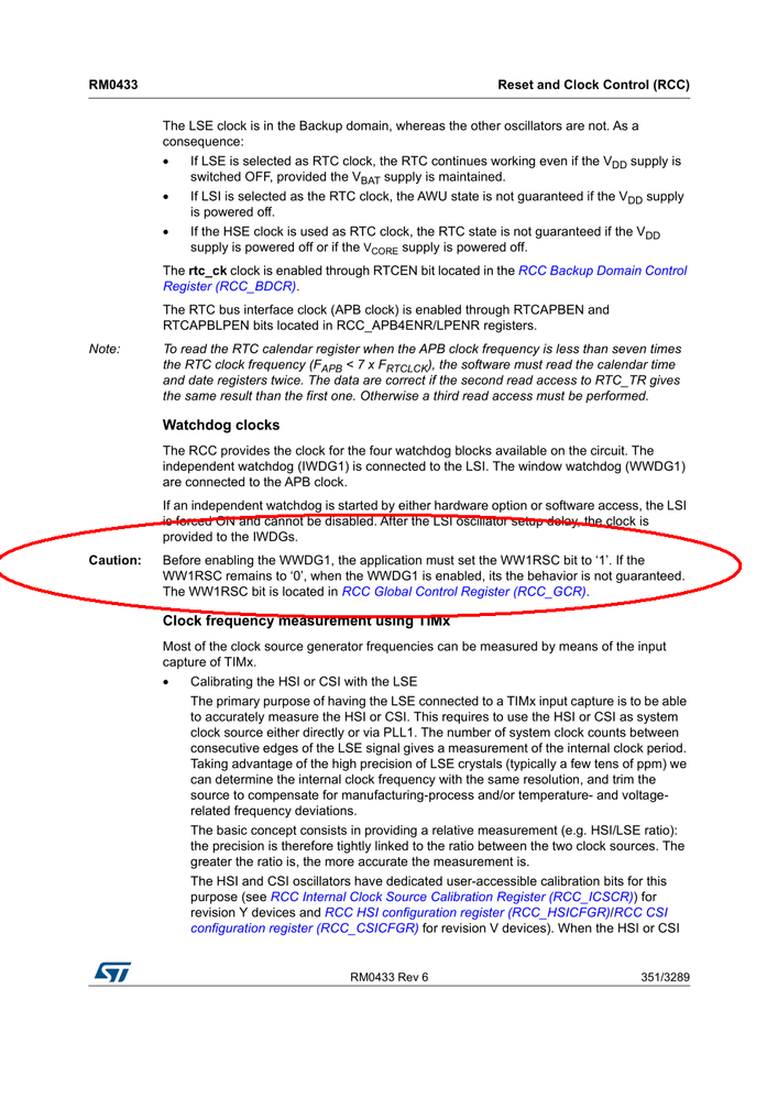

As shown by this thread, this is a nasty gotcha, caused primarily by the "IP chapters in RM don't describe related features beyond their boundaries, even if crucial to their working" policy.

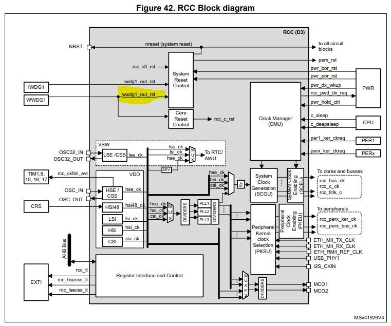

I'd suggest to add references to WW1RSC to each and every place where wwdg1_out_rst is mentioned, namely:
Figure 39. RCC Block diagram - showing a gate controlled by this bit
narrative in 7.4.2 System reset detailing effect of WW1RSC
Figure 40. System reset circuit - showing a gate controlled by this bit
Table 50. Reset distribution summary - pointing out that it's *not* the same effect as pwr_bor_rst, unless WW1RSC is set
Table 51. Reset source identification (RCC_RSR) - detailing behaviour at *both* WW1RSC settings
There's also a mention of wwdg1_out_rst in Table 93. EXTI wakeup inputs - this is entirely unclear to me, how a reset-causing signal would cause and EXTI/wakeup too; but maybe that's also related to WW1RSC - a detailed description would be nice.
A remark, that signals change their names through instatiation, e.g. wwdg_out_rst->wwdg1_out_rst, would be beneficial in all IP chapters, facilitating textual search through the RM. This goes together with an overview of instatiations in the intro of all IP chapters - there are already such, but not in all IP chapters. This case shows, that even where there's only one instantiation (WWDG1), such subchapter is needed.
And, of course, a reference to WW1RSC would be great in the WWDG chapter, but I would be very surprised if that would ever happen, given the policy I've mentioned above.

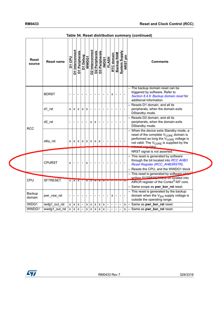

Textual search for WWDG1 reveals more funny things, e.g.
which IMO is bogus:
  • there's no CPURST bit in RCC_AHB3RSTR (nor in other RCC_xxxxRSTR)
  • IMO, CPURST does not *cause* reset of WWDG1 block, but *is caused* by WWDG1 running into reset - again, this will probably depend by WW1RSC
Textual search for CPURST reveals two other apparently related instances, one in CPU reset section of Local resets subchapter, referring to the same nonexisting bit in RCC_AHB3RSTR, and other in the changelog, which says, and I quote:
"Changed CPURST bit to in RCC AHB3 Sleep Clock Register (RCC_AHB3LPENR)."
