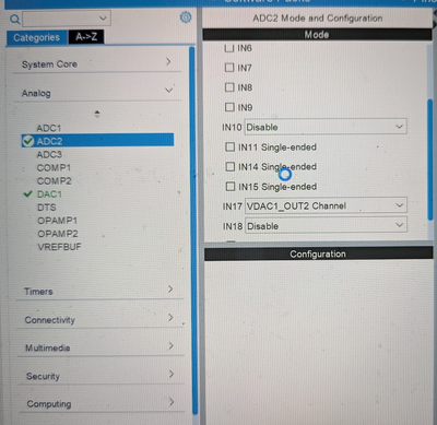

Now we can see that ADC2 IN16 is missing.

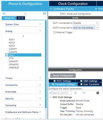

4) Set up the DAC1_OUT2 to peripherals:
5) Setting the ADC2 IN17 leading to infinite loading:
Saving the ioc file now break the application as you cannot do anything anymore.

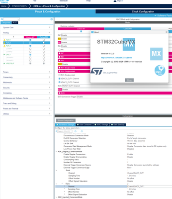

July 29, 2024
In CubeMX 6.12.0 for STM32H755BITx, I can not select DAC1_OUT2 to be monitored by ADC IN17.  IN17 is not available for section - CubeMX skips from IN16 to IN18.
