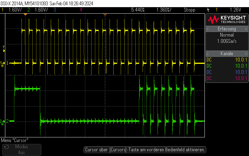

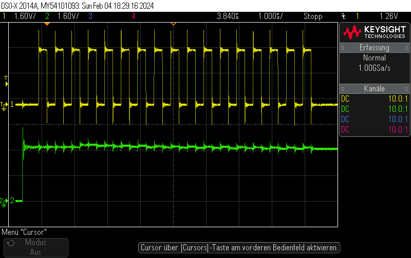

The commands are not failing (HAL_OK), but the Write-Operations are not working. Below you can see two images of scopes from an oscilloscope. The yellow line is the clock signal, the green RWDS. The read operation looks as described in the Hyperbus-Protocol (Command Frame, then 2x initial delay, then RWDS aligned with clock signal). The write operation however stops after the 2x initial delay. Can you find the error here?
Read-Operation:
Read operationRead operation
Write-Operation:
Write operationWrite operation

read and write have individual DQS = RWDS enables, so check this register for the DQSE bit:
/* WRITE: WCCR */
OCTOSPI1->WCCR = OCTOSPI_CCR_DQSE ...

Could you please check the DQSE bit of the OCTOSPI_WCCR because in memory-mapped write you can get an error response when DQS output is disabled.
Workaround
When doing memory-mapped writes, set the DQSE bit of the OCTOSPI_WCCR register, even for memories that
have no DQS pin.
If the DQS output is asserted on memory-mapped writes while the AXI bus transfer has some byte-enable bits
deasserted, the bytes that should be masked get written to the memory.
For more information, I advise you to take a look to the errata sheet section "2.7.6 Memory-mapped write error response when DQS output is disabled".

I'm pretty sure that the S70KL1282's RWDS pin is the same as the DQS signal, so it must be connected and used for both read and write. And it would be a HAL or Cube error if it would not do that.
@niklasdiehm
So, as I already said, check DQSE in WCCR.
Please post your HyperRam init.
Another thing: check the mode you're in, I think in memory-mapped mode you cannot trigger other write actions and vice versa.
PS:
sCommand.DQSMode = HAL_OSPI_DQS_DISABLE;
just saw that, that kills write DQS...
