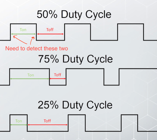

I am very new to embedded programming and I have to modify some code from other developers.
I have to disable the outputs for a PWM and add a callback to get the state of the pulse instead of sending the pulse to the outputs.
I was able to disable the output on PIN 6 but the callback HAL_TIM_PWM_PulseFinishedCallback is never called. HAL_TIM_PeriodElapsedCallback instead is called all times.
I have found the reason why HAL_TIM_PWM_PulseFinishedCallback is never called is because this condition from stm32g4xx_hal_tim.c is always returning RESET:
    if (__HAL_TIM_GET_IT_SOURCE(htim, TIM_IT_CC1) != RESET)
Could somebody help me out?
Thanks in advance.
What do you mean exactly by "callback to get the state of the pulse"? Draw a diagram.
You cannot expect a random function/callback to be called just based on its name. As you've found out, that callback is called upon CC interrupt, which therefore must be enabled, and by further reading Cube code, it is called only when the given channel is set as Output Compare.
Read the TIM chapter in RM. You may want to get rid of Cube/HAL and write your own code.

I need to generate pulses with a given duty cycle and need to detect when the pulse is rising and falling before and after the duty cycle.
The idea is that the PWM was controlling the strobe of a lamp by turning on and off the output. But that's not possible anymore and the lamp must be have voltage continuously and the strobe must be controlled my changing the brightness of the lamp instead. What I did is to disable the output at the PIN number 6 for channel 1. But I would like to get the rise and fall events at the beginning and the end of the duty cycle so that I can change the brightness of the lamp between 0 and 99 to perform the strobe.

Try this: set up the PWM to output say 50% duty onto the pin, observe it using oscilloscope/logic analyzer. Then open the reference manual in the Timer chapter, at the end where the registers are described, and in the debugger, stop program execution, and play with the given timer's registers, observing what are the effects of what you do.
> sConfigOC.Pulse = 0;
By doing this, you effectively disable the PWM entirely, as you set 0% duty cycle.
If you want to run the timer's channel in PWM mode and not have it output onto its pin, simply disable given channel by clearing its respective TIMx_CCER.CCxE bit. You can also change the given pin's setting, e.g. in its respective GPIOx_MODER field change it to Input. In both cases the timer continues to run and the channel continues to generate the PWM, except that it is not propagated to the pin.
The Update interrupt is triggered by one edge of the pulse, and the CCx interrupt is triggered by the other. So enable the CC1 interrupt by setting TIMx_DIER.CCxIE.
For everything I wrote above there is certainly a Cube/HAL macro, but I don't use Cube/HAL so I don't know them. You can look them easily up yourself, Cube is open source.

I have been able to disable the output by:
GPIO_InitStruct.Mode = GPIO_MODE_INPUT;
But still not luck with the interrupts. I am using this code to enable them but HAL_TIM_PWM_PulseFinishedCallback still not called:
__HAL_TIM_ENABLE_IT(&htim3, TIM_IT_UPDATE);
__HAL_TIM_ENABLE_IT(&htim3, TIM_IT_CC1);
__HAL_TIM_ENABLE_IT(&htim3, TIM_IT_CC2);
__HAL_TIM_ENABLE_IT(&htim3, TIM_IT_CC3);
__HAL_TIM_ENABLE_IT(&htim3, TIM_IT_CC4);
 HAL_TIM_PeriodElapsedCallback is called constantly.
waclawek.jan
Read out and check/post the TIM registers content.
I could manage by editing with the HAL tool. I had to change the output channel to Generate No Output in CubeMX and started working. Also had to place the above code in the right place.
Thank you for your help :)
